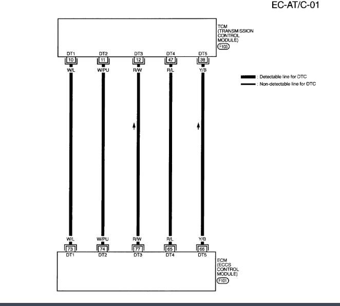

The 600 is for communication between the TCM and the ECM. Without the VSS signal, this could be the issue.

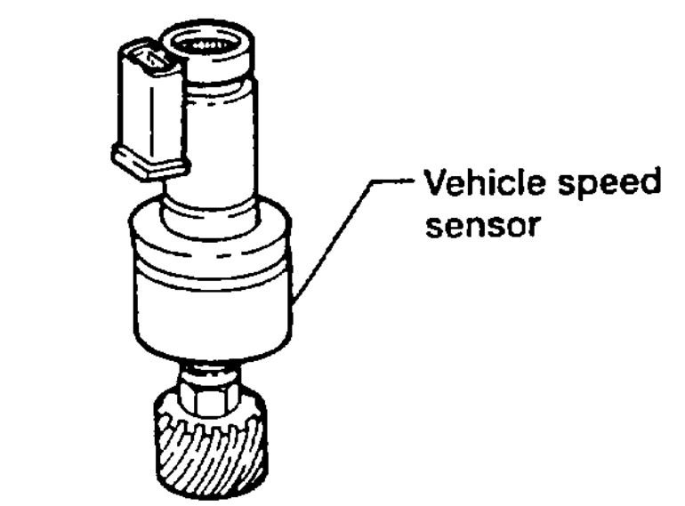

VEHICLE SPEED SENSOR (VSS) (DTC: P0500)
The vehicle speed sensor is installed in the transaxle. It contains a pulse generator which provides a vehicle speed signal to the speedometer. The speedometer then sends a signal to the Engine Control Module (ECM).

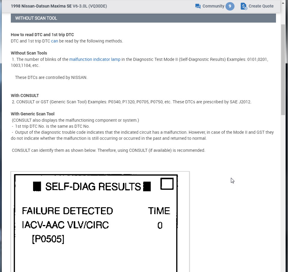

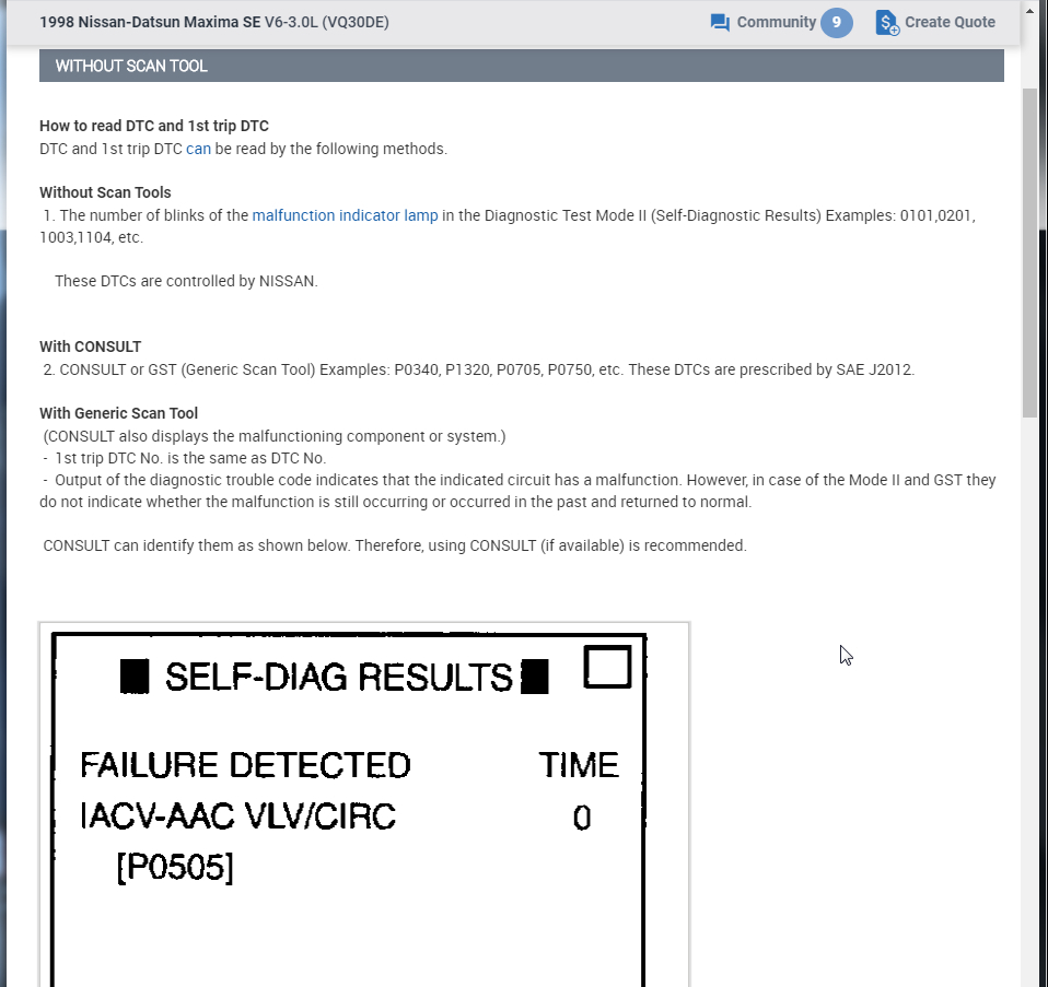

Cannot find any parts store with abs scanner. All recommend shop/diagnostic charge. Going to research pulling codes by hand counting flashes while shorting obd plug.
Apr 11, 2020 at 2:50 AM
Just to jump in but it looks like you can pull check engine light DTCs this way but I don't see a way for the ABS system. I could be wrong but I don't see it in the manual.
Apr 11, 2020 at 8:09 AM
JOHNDUBE66
  • 22 POSTS
In all honesty I didn’t look it up for a Maxima yet I did for my wife’s Honda Odyssey and it showed me the bottom middle pin in the top right I think number nine, but again that’s for a Honda that’ll make the ABS light flash.
Apr 11, 2020 at 10:03 AM
This video should help you:
https://youtu.be/rTtAnsOlZU4
Apr 11, 2020 at 1:36 PM

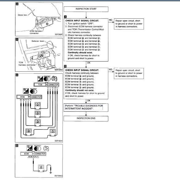

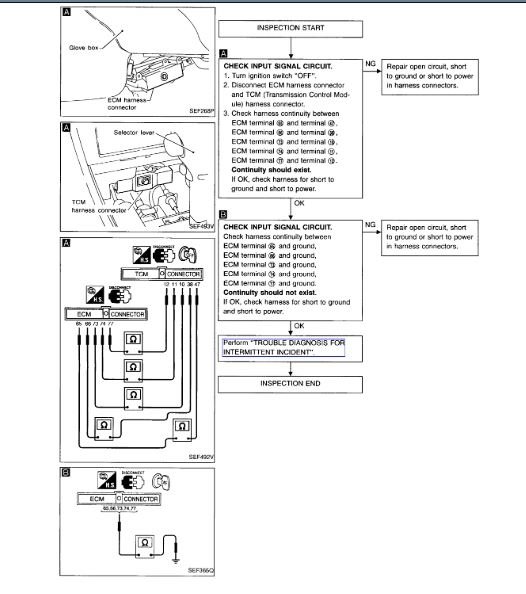

Just an update: I do have a cheap scan tool and I scan my check engine light after clearing it to get fresh codes I got a whole 500 speed sensor. which I’ve already installed new on the transmission I got a 600 communication with the computer? And I got 1400 EGR.
Apr 11, 2020 at 3:21 PM

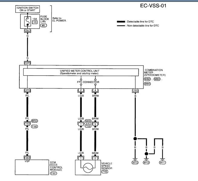

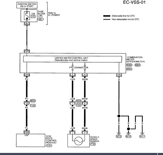

Okay, I attached a wiring diagram of the speedometer system. The wires go directly to the speedometer and is decoded in the speedometer head itself.
You need a scope to check the actual signal to see if it is coming from the sensor. If you replaced the sensor, it could be wiring from the sensor to the speedometer or the speedometer head itself.
The 600 is a communication issue between the ECM and the TCM. This will not effect the ABS.
