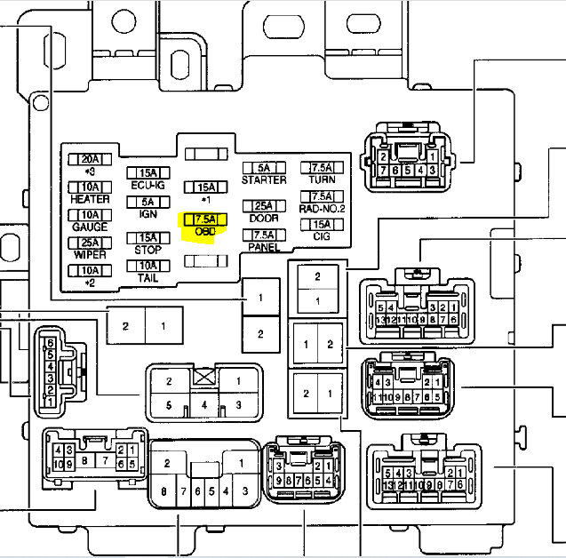

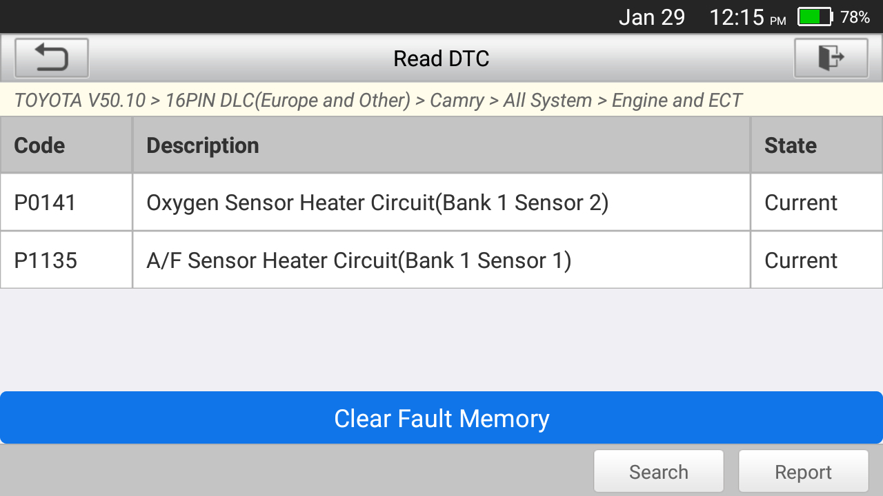

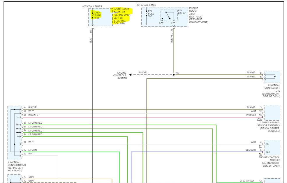

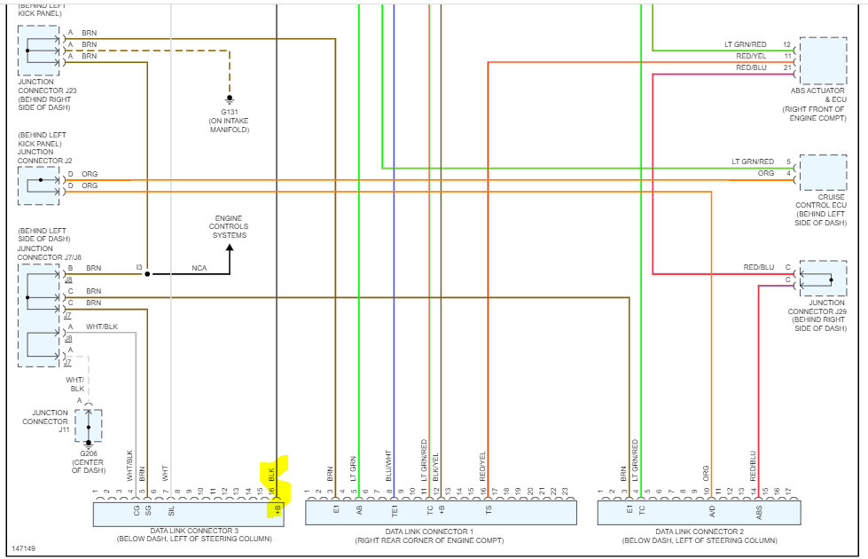

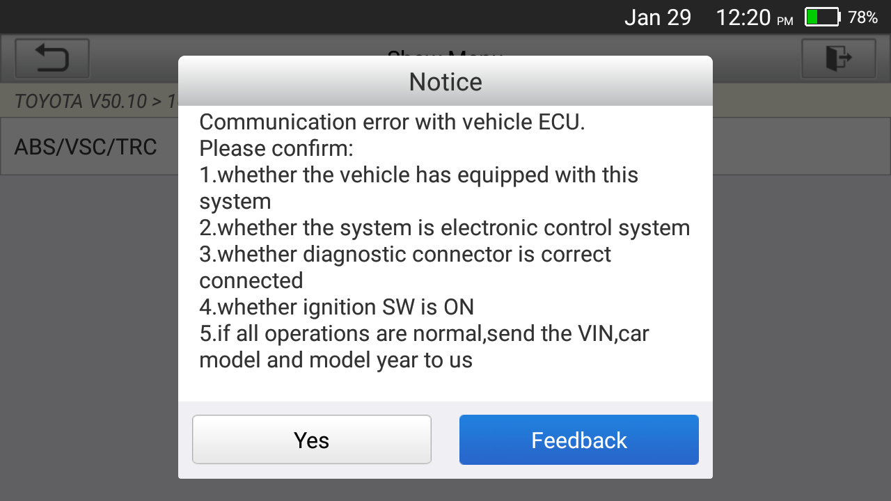

The ABS light lights on the combination meter, I tried to read the code using scanner, but the scanner was unable to communicate with it. What could be the cause of the light and how can it be diagnosed? What is displayed is shown below?
