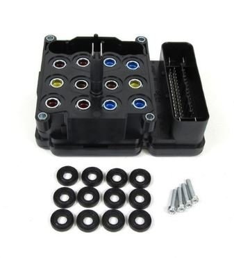

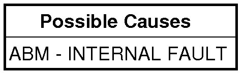

Three days ago, me and the wife were driving out of our parking spot and as soon as 100 yards on the road all the lights described above turned on at the same time, next step was to order a OBD2 reader that also reads ABS codes, I found code C2200, antilock breaks module failure?
Upon reading on Jeep forums I discovered that these Jeep's tend to do this quite often, a lot of people recommends checking battery and connections, everything looks good, some people also say to disconnect battery for 10 min and basically reset the computer, I did all of these and the lights are still on, some guys just replaced the speed sensors, all of them or some and they resolved the issue, but usually they got a code pointing towards speed sensors, I would find it interesting if any of these repairs would fix my code since the code I am getting is straight forward C2200.
Should I try replacing sensors first?
Or should I just get a new module and then take it to the dealership so that they can program it?
Thank you.
