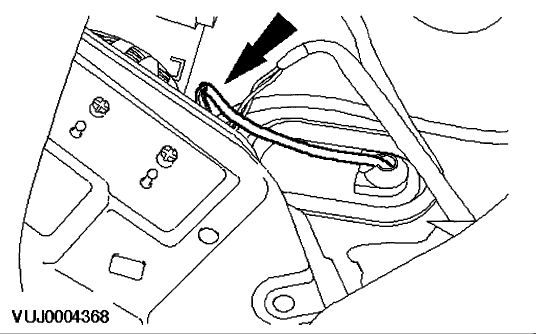

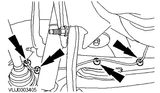

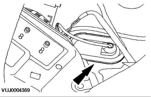

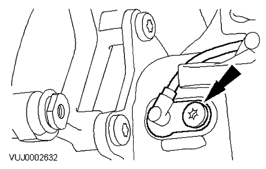

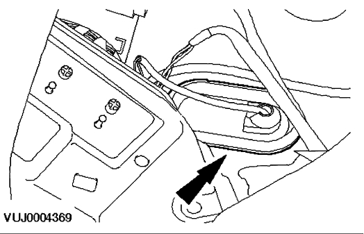

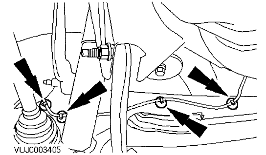

Here are general directions for replacing a sensor:
https://www.2carpros.com/articles/how-to-replace-an-abs-wheel-speed-sensor
______________________________
Here are the directions specific to your vehicle:
2003 Jaguar X-Type (X400) V6-2.5L
Vehicle » Brakes and Traction Control » Sensors and Switches - Brakes and Traction Control » Wheel Speed Sensor » Service and Repair » Rear Wheel Speed Sensor
REAR WHEEL SPEED SENSOR
Removal
Remove the rear seat cushion.
Disconnect the rear wheel speed sensor electrical connector.
Detach the grommet.
Raise and support the vehicle.
Detach the ABS wheel speed sensor wiring harness.
Remove the ABS sensor.
Installation
To install, reverse the removal procedure.
Tighten to 22 Nm.
________________________________________________
The attached pictures correlate with these directions.
I hope this helps. Let me know if you have other questions.
Note: Remember, this is the right rear sensor that is causing the problem. That would be the passenger side of the vehicle.
