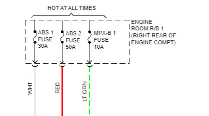

There are 3 fuses for the ABS module.
2 in the engine room fuse block, ABS fuse 1+2.

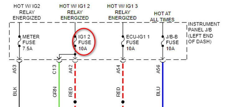

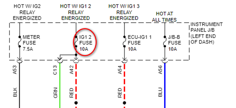

The third fuse is located in the dash panel fuse block, fuse IG1 2.
