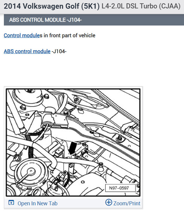

You didn't start the engine before running the codes correct? To me to sounds like the ABS control module has gone bad, here is how to replace it. This problem is not obvious, if you want to take it to the dealer, I would not blame you. Check out the images (below). Please let us know what happens.

so we replace the ABS control module.
