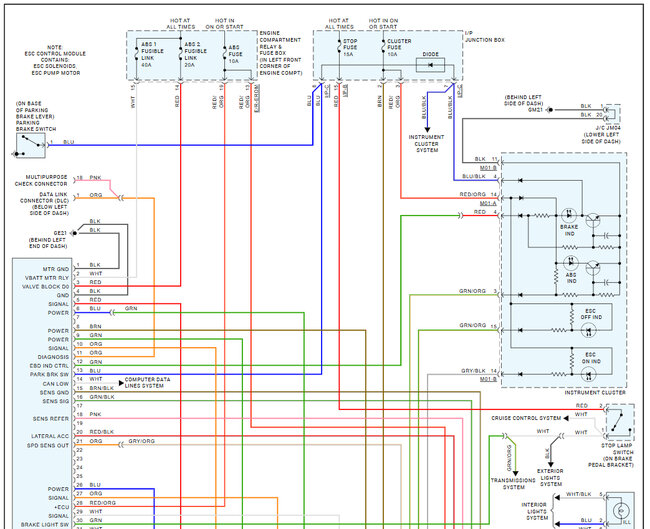

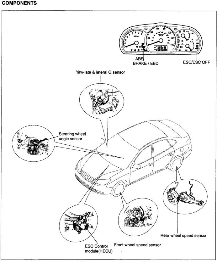

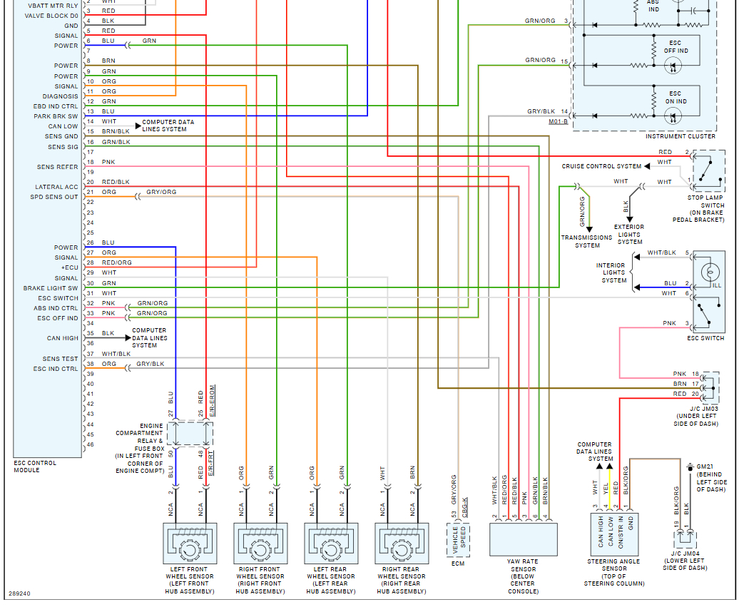

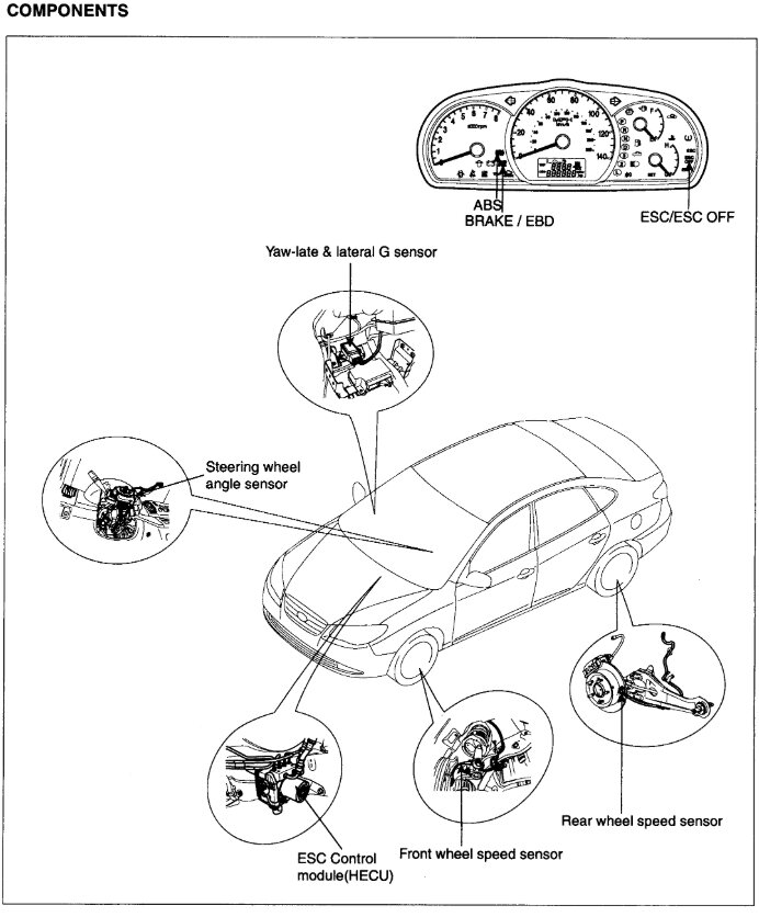

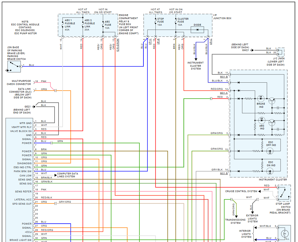

So you might have two problems, one is the bearing hub on the right rear is out which will cause the reluctor wheel not to line up with the sensor so I would check that, you can remove the sensor and look down the hole to check alignment and a shorted connection inside the steering angle sensor that can cause this problem so you will need to test. Also, it can be the ESC module itself (rare).
C1237 - ABS Wheel Speed Sensor Circuit Fault (Usually Rear-Right)
C1513 - Steering Angle Sensor Malfunction
You can use this guide to test through the wiring or try to replace the steering angle sensor and then clear the codes. Here is a guide to help and the ABS system wiring diagrams as well:

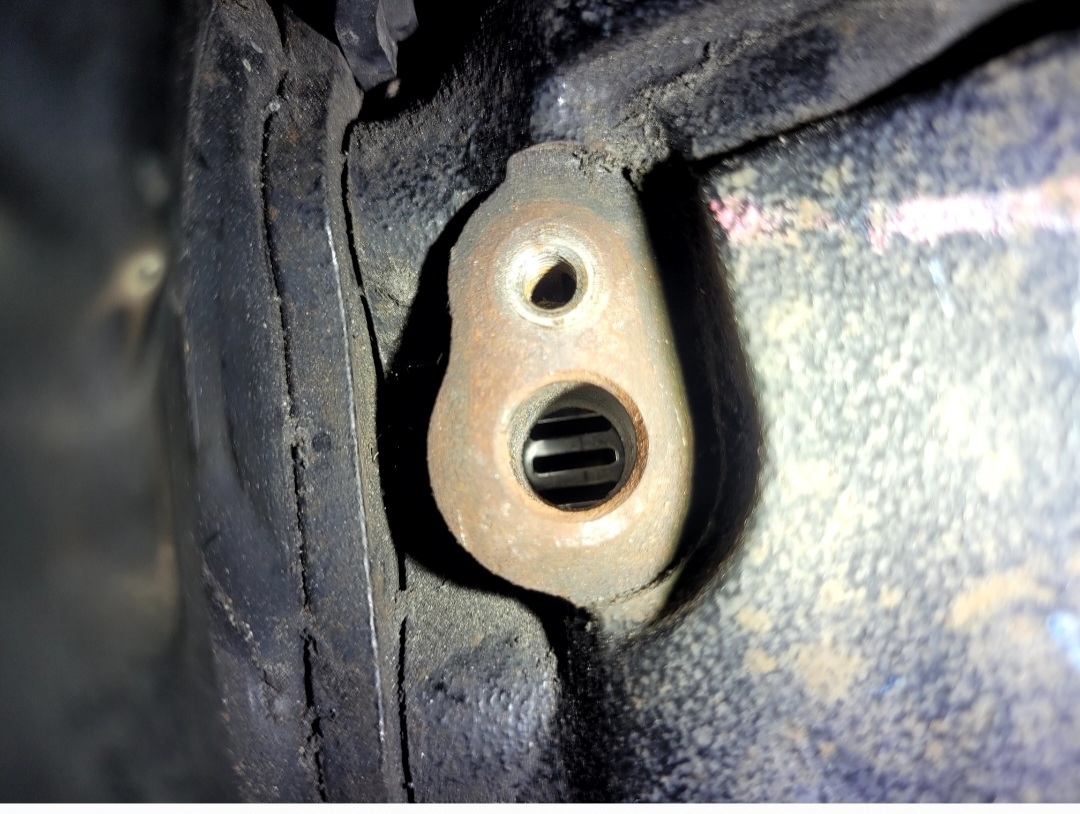

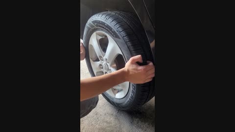

Bearing hub doesn't show any play and what I believe to be the reluctor wheel seems aligned when spun.
Jul 23, 2025 at 3:17 PM
Okay, we can rule the hub being bad. I would test the wiring though the steering wheel angle sensor and if okay replace the ABS control module. Thanks for the video and images.
