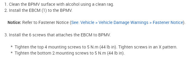

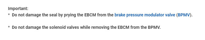

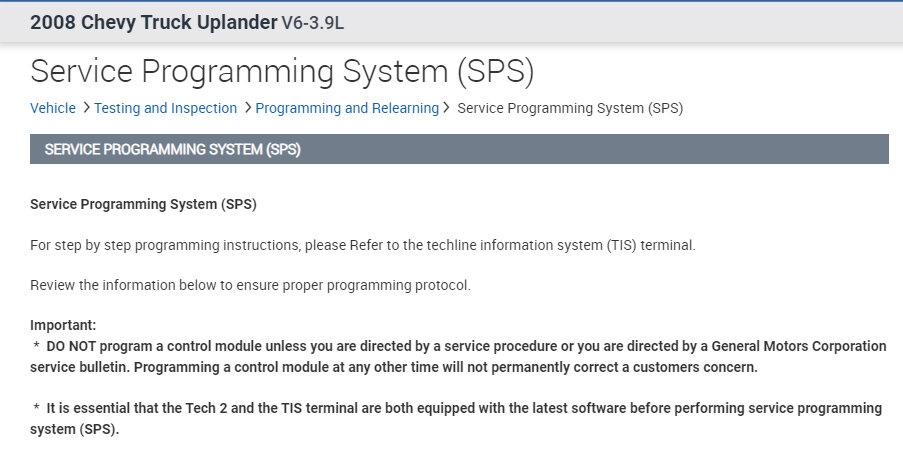

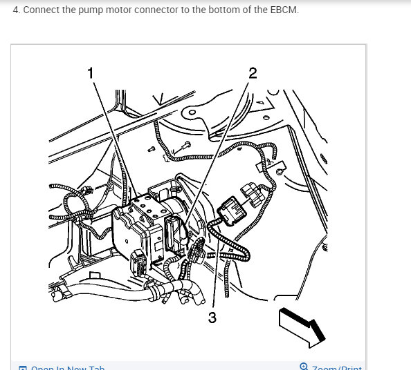

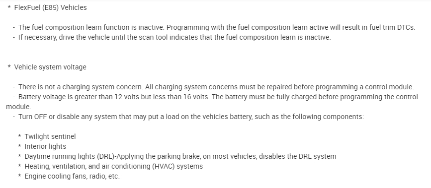

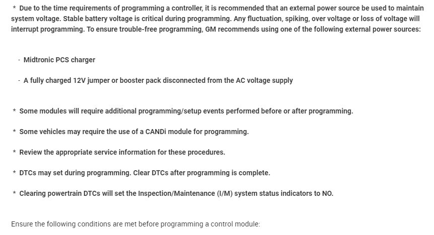

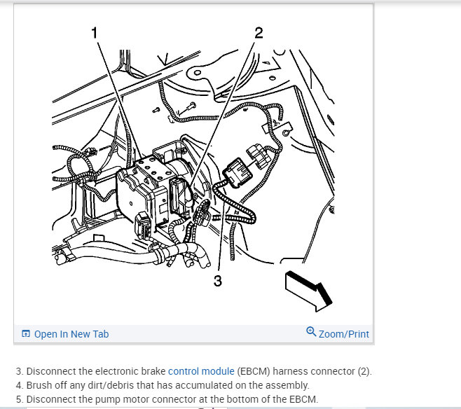

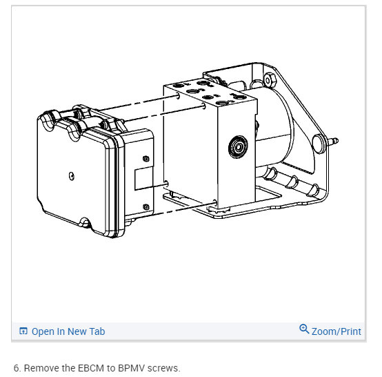

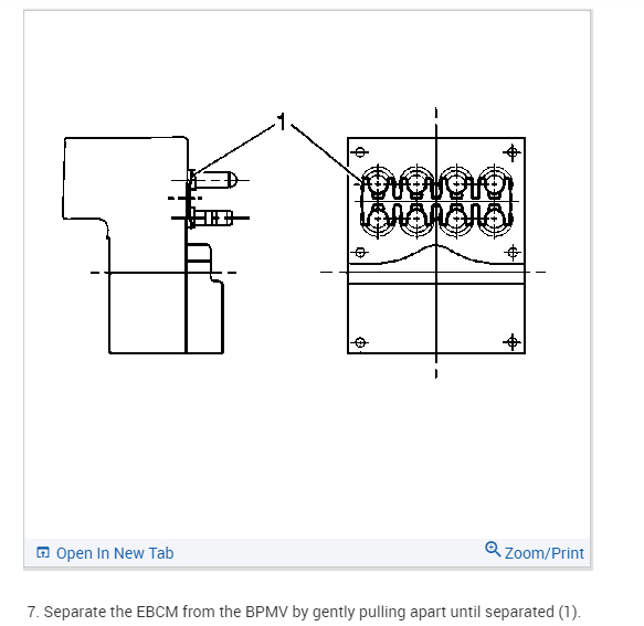

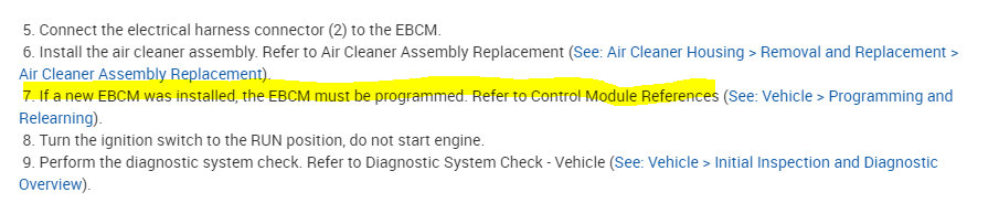

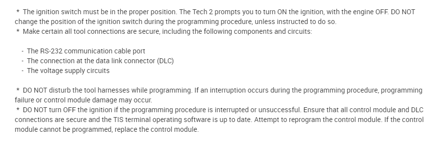

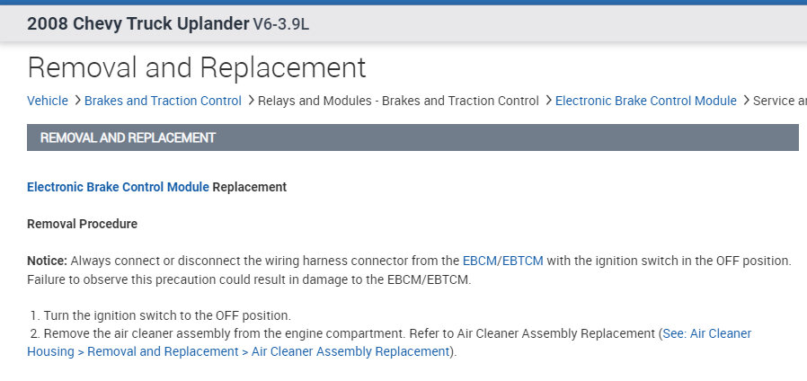

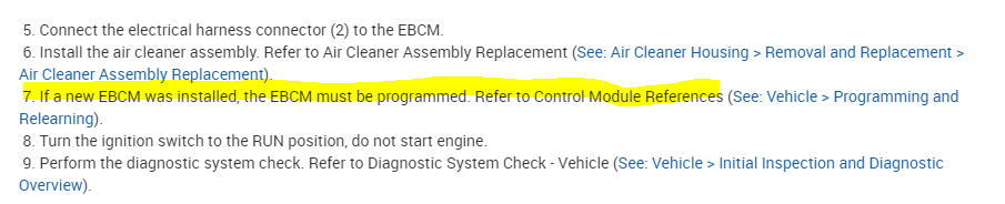

The ABS pump motor runs continuously. We believe the control module (EBCM) is at fault and intend to replace it. Any gotchas? Any special advice on making it go smoothly and painlessly? For this model, will the EBCM require reprogramming as well?
