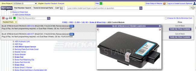

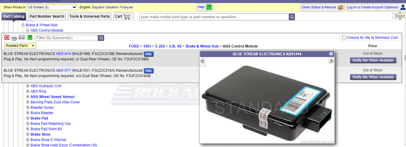

They did not have a picture but I found the module at rock auto and attached it for you.
https://www.2carpros.com/articles/abs-brake-system-repair
It is under the dash on the drivers side.
