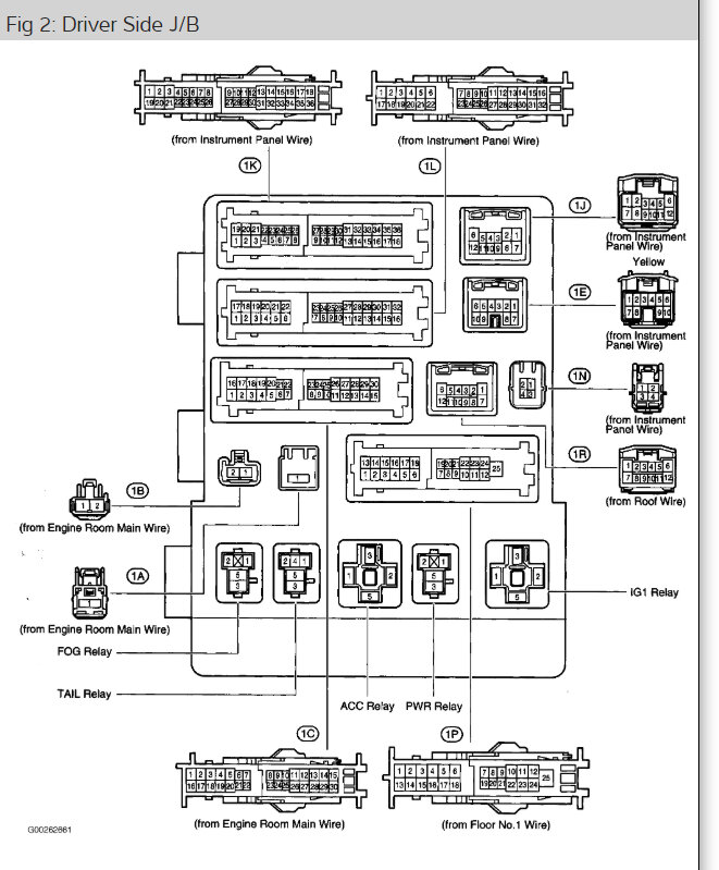

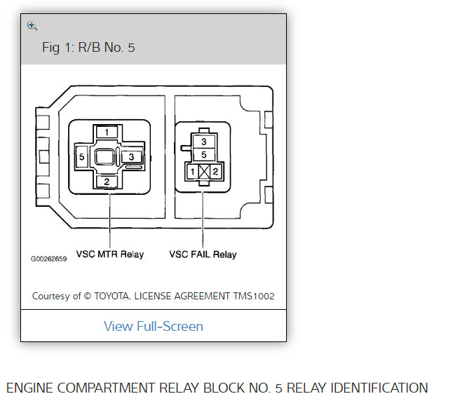

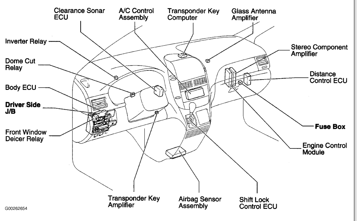

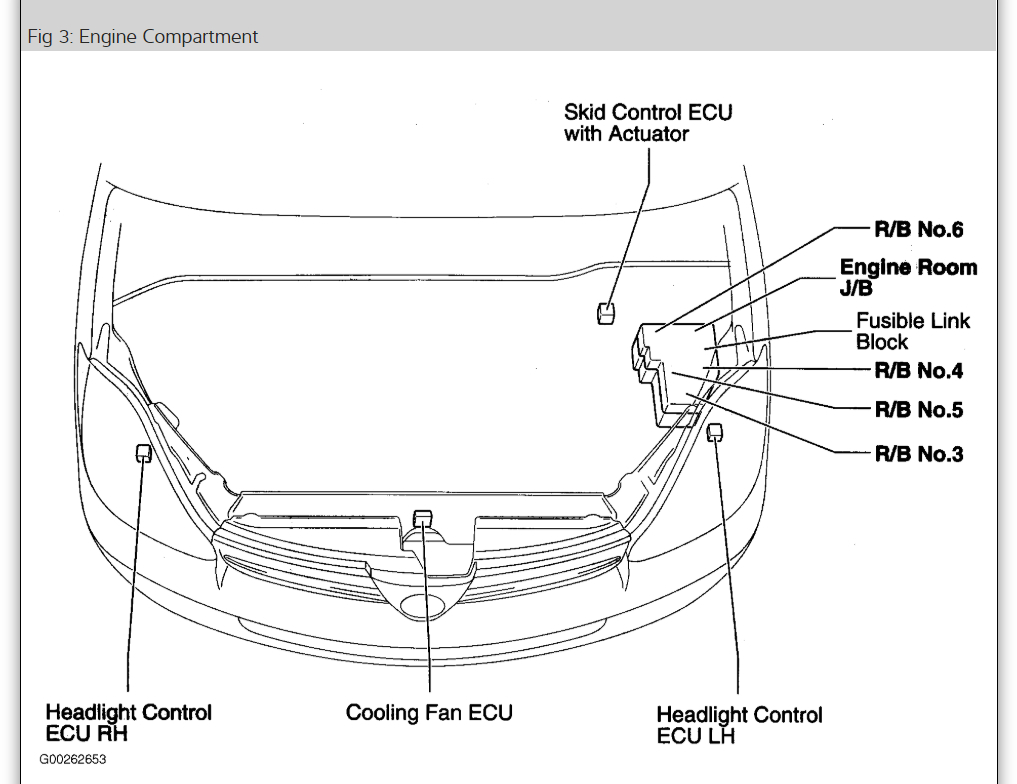

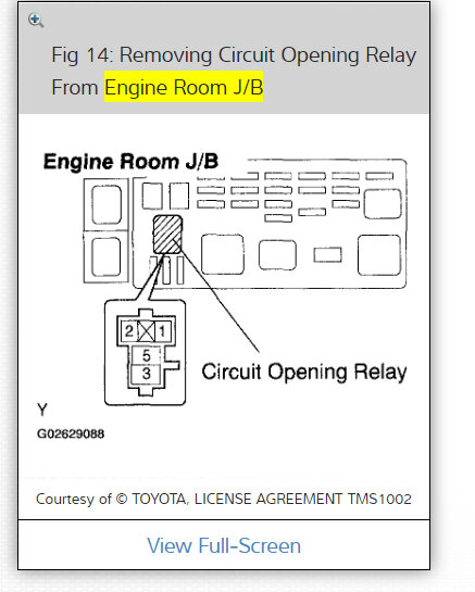

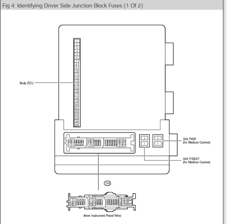

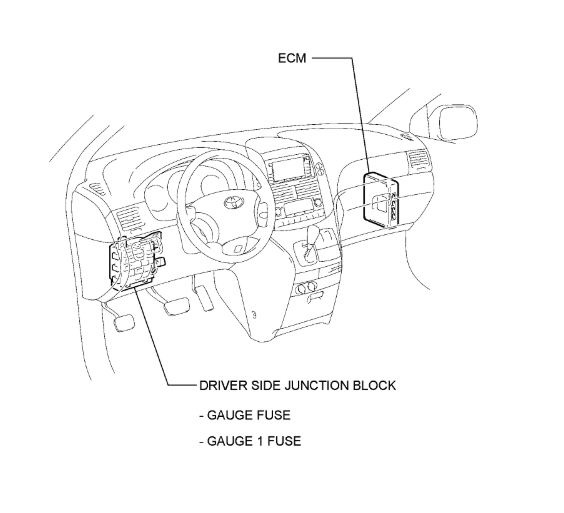

I have seen the instrument cluster short out and cause this problem, but we should check all fuses and run a CAN scan.

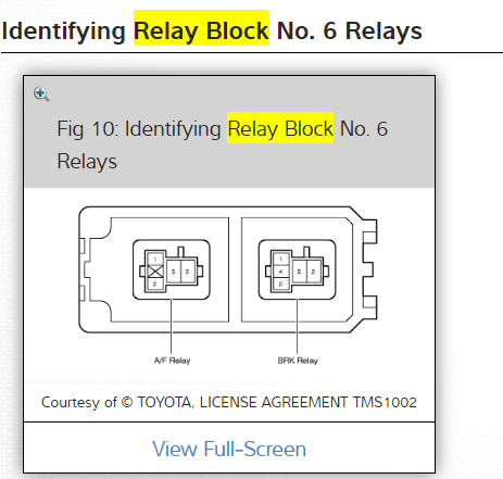

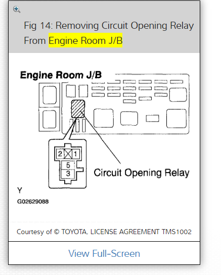

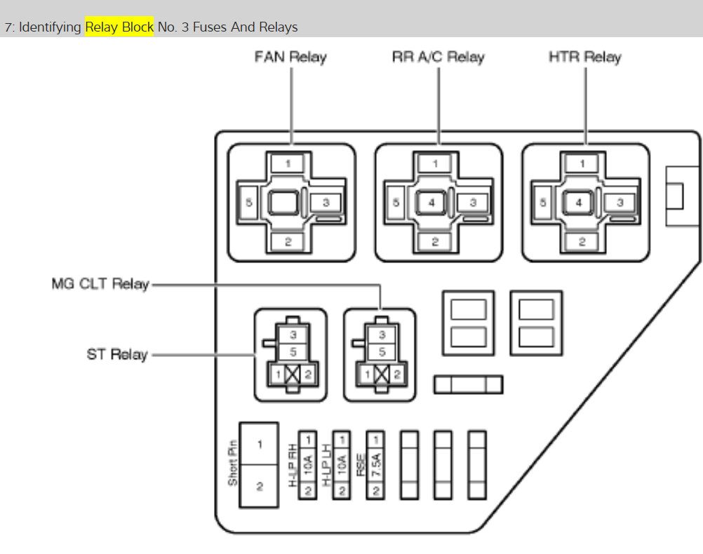

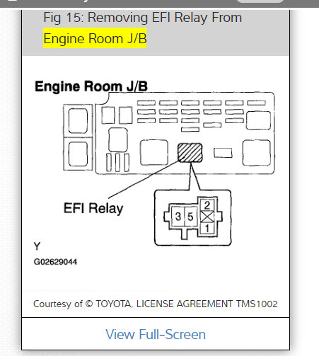

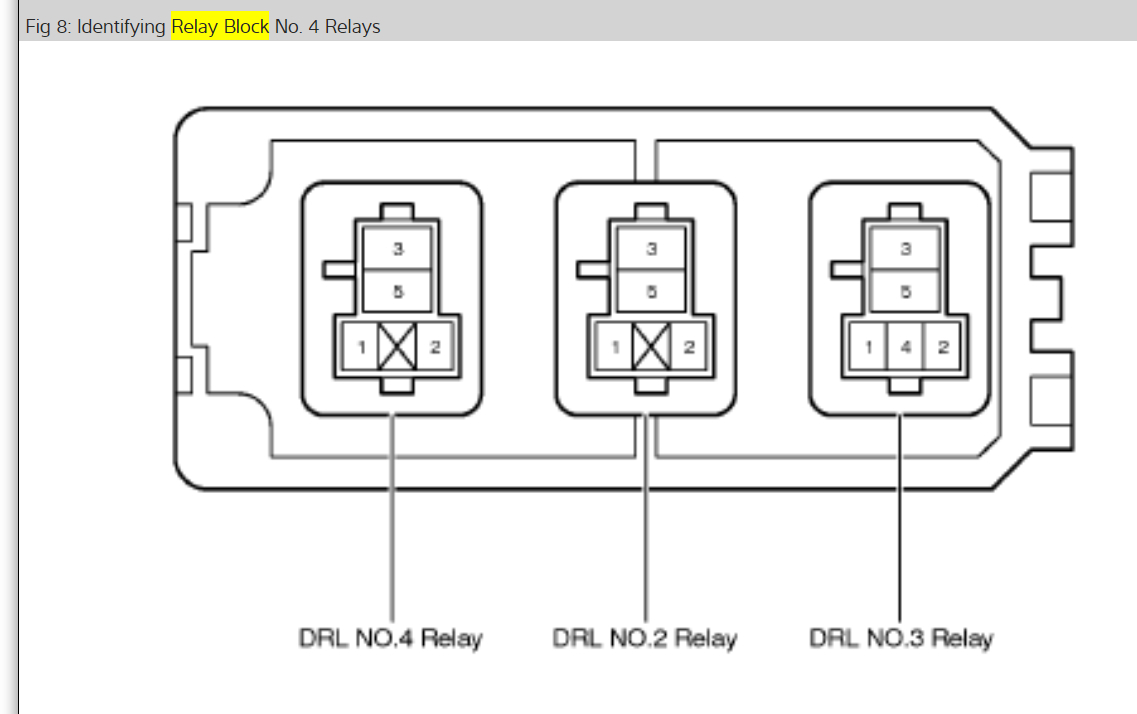

Here are guides help and fuse location in the images below:

Check out the images (below). Let us know what happens and please upload pictures or videos of the problem so we can see what's going on.

Thank you for your answer. We checked all the fuses and noticed a fuse was missing. Apparently after they changed the main fuse they failed to replace a fuse that was taken out.
