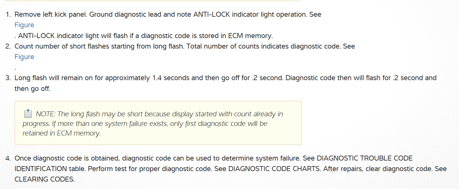

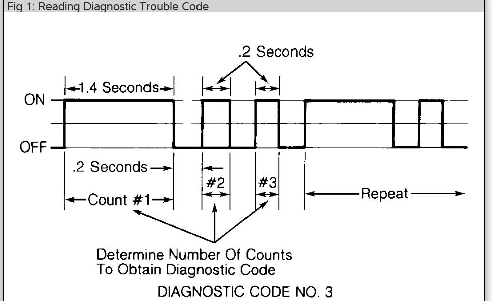

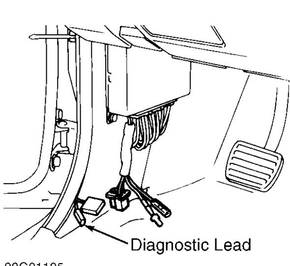

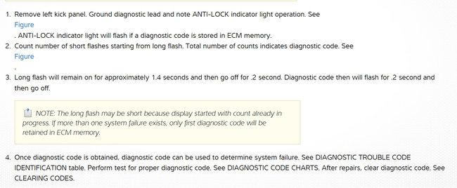

for check engine light cross A&B on aldllower left dash and count flashs like 1 then 2 is 12 etc. see pic on how to get codes for abs and get back to us with codes....
