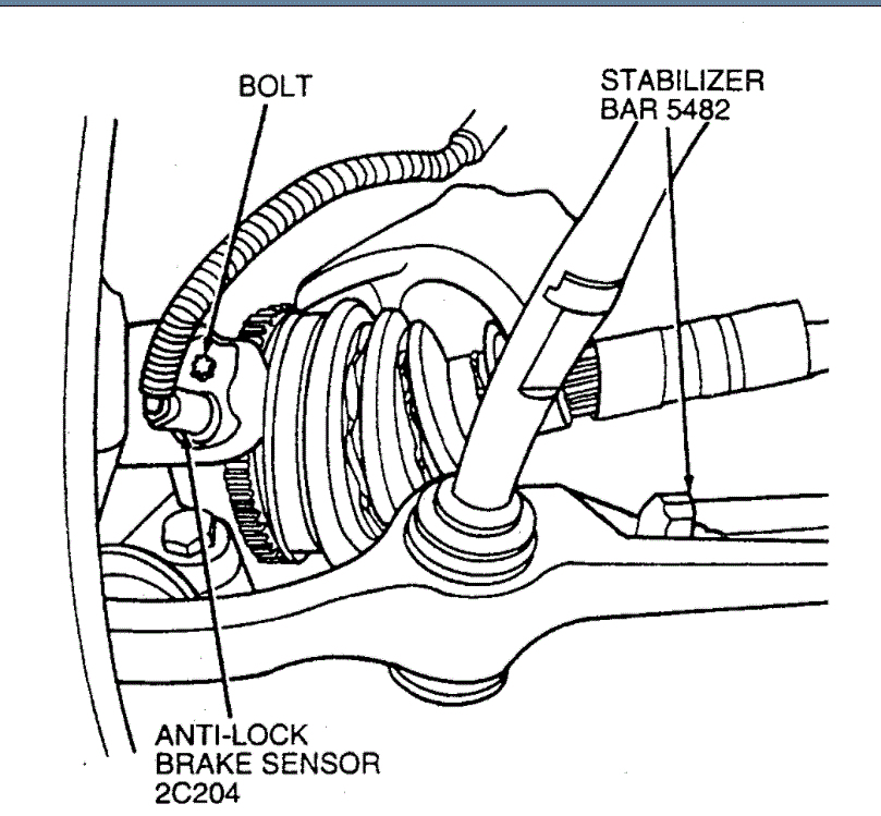

There really isn't a specific air gap that is provided. The sensor length is what determines that. What is the part number of the sensor they gave you?
Also, I attached a pic below. Does this look like the design you have?

Yes, it looks like the pic. Part # Dorman 970015

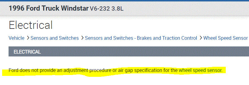

There really isn't an industry standard. However, it needs to be close to produce a reliable and strong signal.
I'm a bit confused about something. You indicated that a .004 feel gauge touched certain points. The tone ring should run true, so if it hits a .004 gauge, it should hit at all points of the tone ring. Is that happening?
Now, some sensors can be adjusted when installed. However, this one isn't. IF you look at the attachment below, you'll see what I have in my manual. When no adjustment is provided, there isn't a procedure for adjustment.

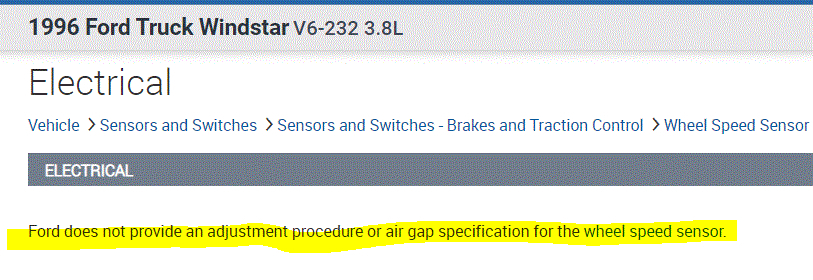

One other question. Have you physically compared the old and new sensor lengths to see if they are the same?
See pic below.
