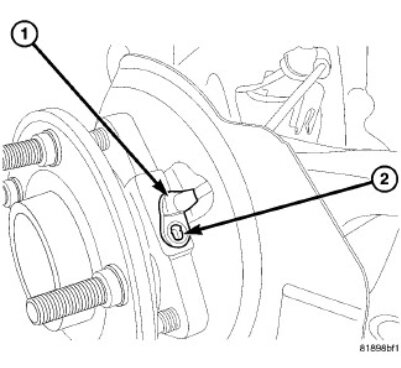

These lights came on a couple of days ago. I don't even know where to start because I haven't seen this before.
Aug 30, 2025 at 3:23 AM
It is problem a wheel speed sensor that has gone out which is common, here is the video to show us how to get a code out of the system which will tell us which wheel speed sensor is having an issue. Please go over this video to see how
https://www.youtube.com/watch?v=HvooM1X2SDs
It is usually a front sensor here is the location in case you need it. Check out the images (below). Please let us know what happens.
