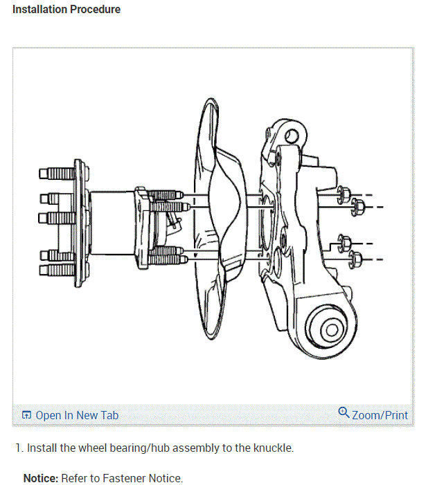

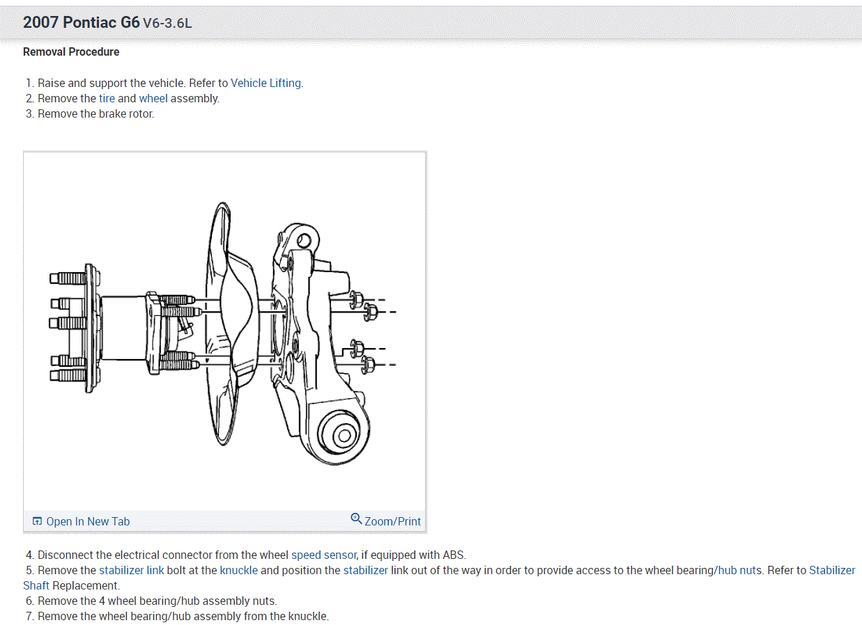

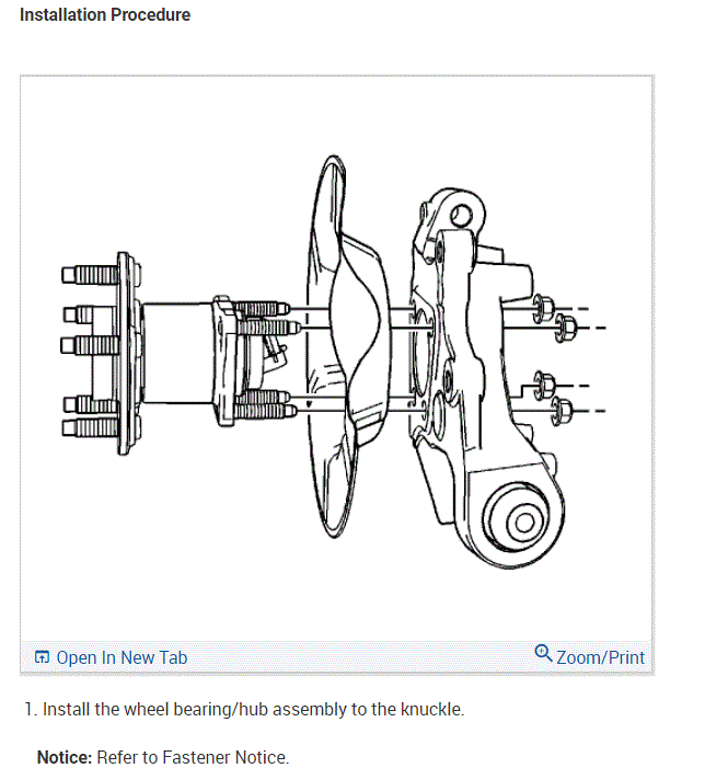

If you look at the attachments below, I provided the directions for the rear hub/bearing assembly removal and replacement. You will need to replace the unit simply because the sensor is part of the bearing assembly.
