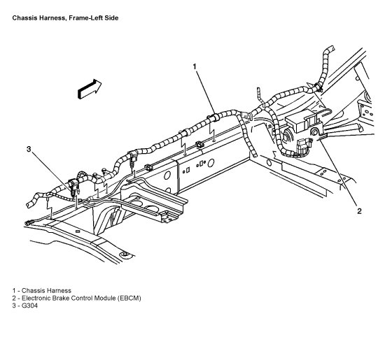

Sorry. I should have mentioned the code in my original question. I did scan it and the code it gave me was C0265 (solenoid valve relay circuit). Is the control module located on the side of the frame under the driver's seat? I think I see it but wow it is in a hard spot to get to!

That code is EVIL.... But you might be able to take care of it easily. There is a TSB on it because of a faulty ground. And you are correct on location. The parts they use are GM 11588337 (M6 sized bolt w/washer head),

1. Remove the EBCM Ground. The EBCM Ground is located on the frame beneath the driver's side door. If multiple grounds are found in this location, the EBCM ground can be identified as the heavy (12-gauge) wire.

The ground is a ways back on the frame up toward the top flange if I recall. If it's got a good ground it is likely that the module is bad, there are a couple of items that can fail inside and cause problems. I don't bother repairing them normally but I guess you could.

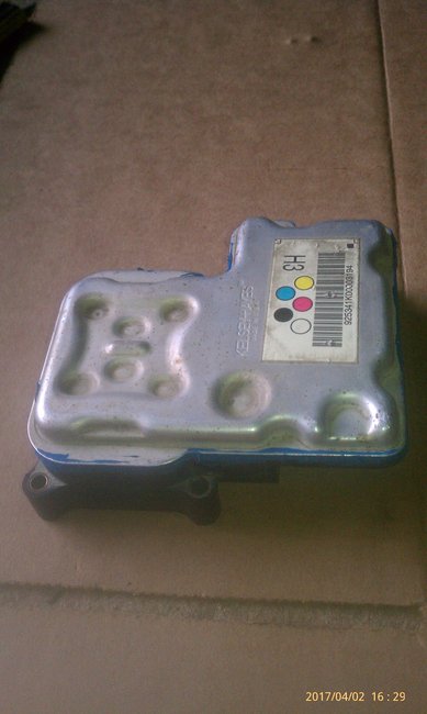

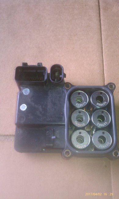

Thanks again for all the info. I took it apart and didn't see anything that stuck out as being wrong. I went ahead and heated up four solder points on two of the plug points then resealed it back together. I did all this before I got your last message about the pics. Sorry but I did take sum pics of something else I found that didn't look quite right. I was getting ready to put it back on the car and noticed some discoloration on one of the pistons.i don't know much about the antilocking systems. I'm thinking about spraying some penetrating oil on six of them and buttoning it back together. Then cleaning one more ground that's a little farther back and seeing what happens. With my fingers crossed of course. Worse case scenario I'll go get another setup at the junkyard. Does anybody know if this system is compatible with another vehicle's setup? I'm trying to find one that under the hood and easily assessable. I'll post the pics I took. Thanks again.

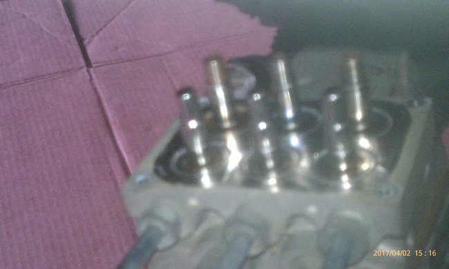

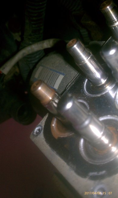

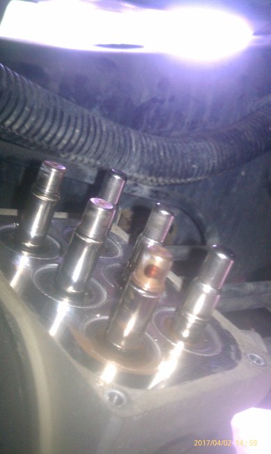

The photos you included, (thank you), show the valves that control the flow of brake fluid during a skid. There is no brake fluid on that side, but still, do not use any type of oil there. That oil can reach the side of the rubber lip seals opposite of where the brake fluid is. The problem isn't the oil getting into the brake fluid. The problem is the rubber is not compatible with petroleum-based products. Brake fluid is a glycol product. The rubber will become soft and mushy, and will grow bigger. That will impede the movement of the valves at first, and eventually the seals will start to leak.
Those valves move first to block fluid flow to a wheel that is slowing down more than the others when the brakes are applied. If the wheel speed doesn't pick back up, another valve opens to bleed fluid pressure off. Once the wheel speeds up again, another valve opens to allow more brake fluid to flow to that brake. This "block, bleed, apply" can occur up to 30 times per second, although most systems do that just as effectively at 15 times per second. That is the buzzing you hear and feel when the ABS engages.
