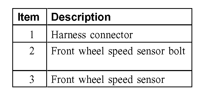

If you determine one of the sensors has failed, here are the directions for replacing them. I will start with the front. All attached pictures correlate with these directions.
Front Wheel Speed Sensor
Removal and Installation
1. Disconnect the battery.
2. Remove the RH front rotor.
See Pic 1 and 2
3. Remove the parts in the order indicated in the following illustration and table.
4. To install, reverse the removal procedure.

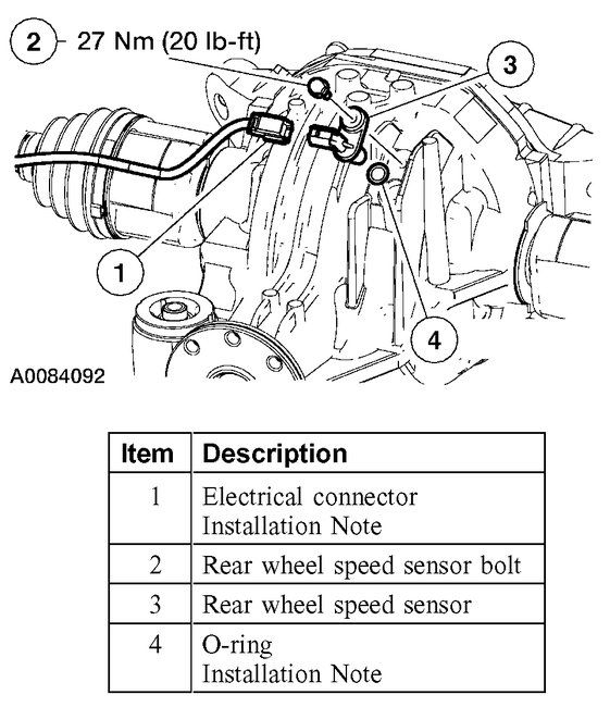

Rear
Rear Wheel Speed Sensor

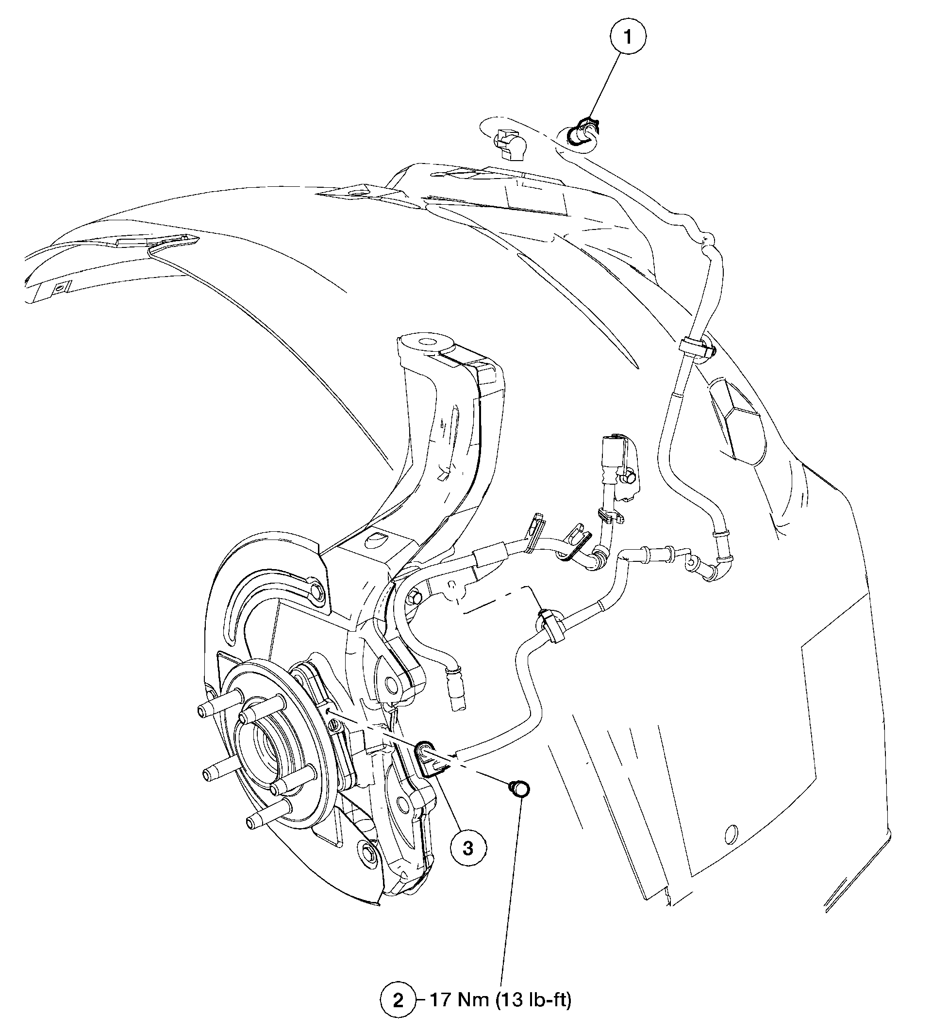

2. Raise and support the vehicle.
Pic 3

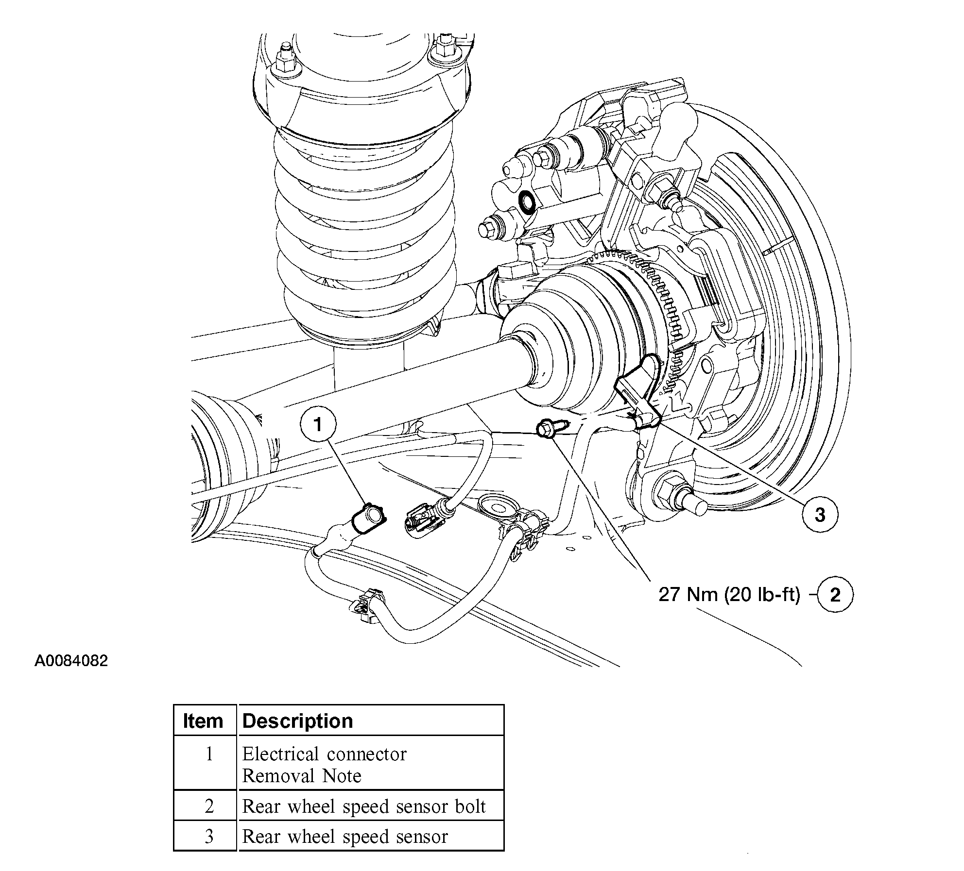

3. On vehicles equipped with anti-lock brake system (ABS) only, remove the parts in the order indicated in the following illustration and table.
Pic 4

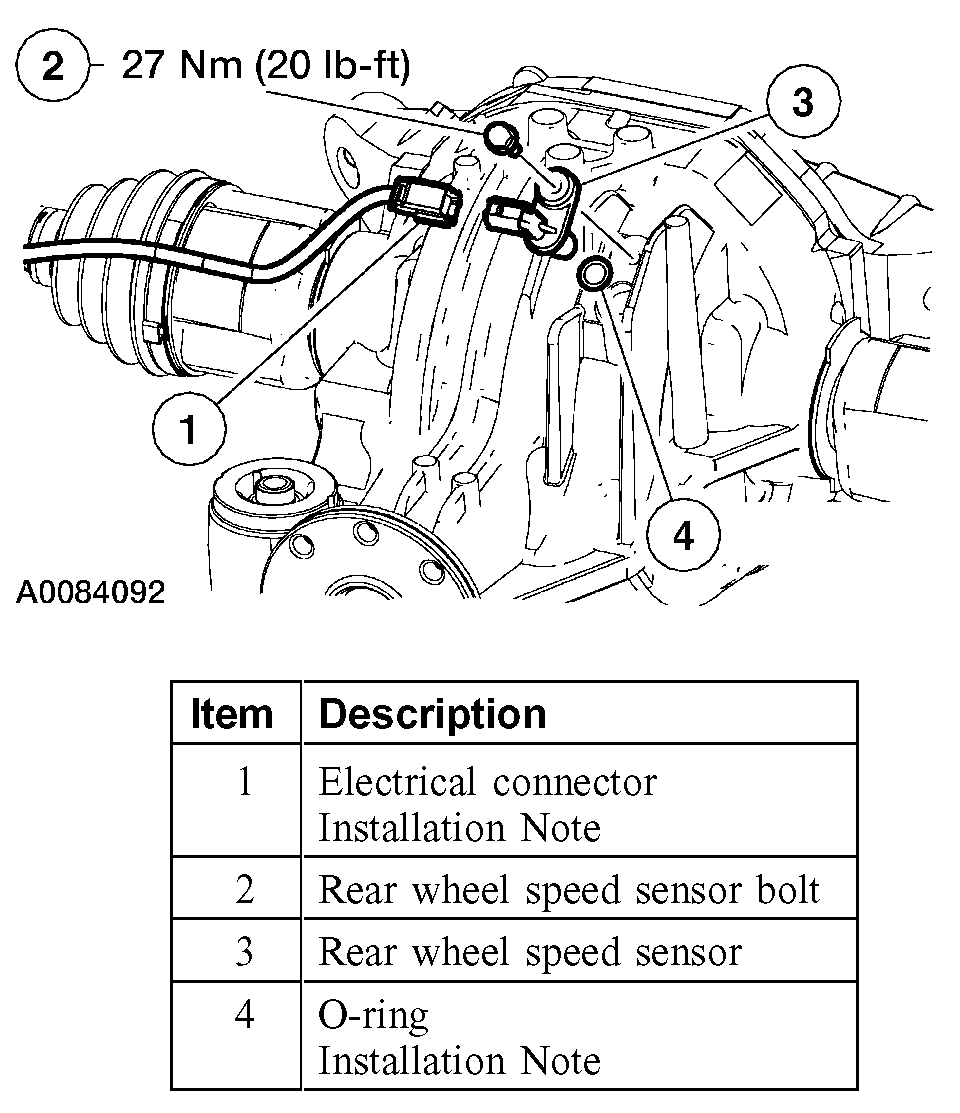

4. On vehicles equipped with ABS with stability assist, remove the parts in the order indicated in the following illustration and table.
5. To install, reverse the removal procedure.
Item 1 (ABS With Stability Assist): Electrical Connector Removal Note
1. Remove the rear wheel and tire.
Item 4 (ABS Only): O-Ring Installation Note
1. Install a new O-ring.
Item 1 (ABS Only): Electrical Connector
Installation Note
1. Apply electrical grease to the connector terminals.
