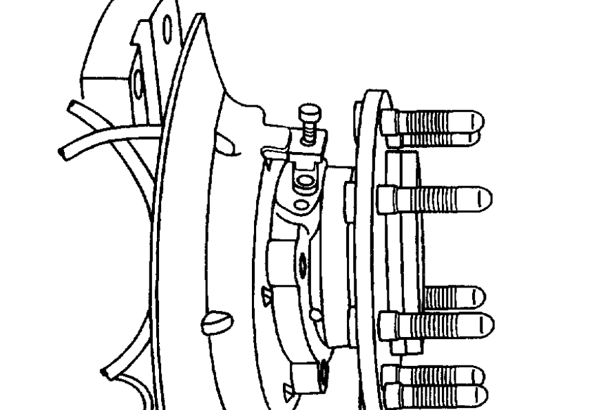

I changed the left front wheel sensor. I put all the spacers back on it from the original sensor. The and light still came on and the anti engaged. I took two spacers out. There is five all together. The light stayed out. But at low speed two to eight mph the anti engaged again. I took it apart and left one in the light comes on and the scan tool says it is the right side. I cleared the system each time before I test drove it. Am I missing something? Thought it would be and easy fix. Needless to say here I am.
Apr 14, 2018 at 6:15 PM
Good evening.
I would start by removing the new sensor and cleaning the mount on the hub. make sure it is cleaned of all rust and debris.
I would also do the right front as well. a common failure is the mounts get dirty and the air gaps get affected by that dirt. they set codes and have ABS activation at slow speeds just before stopping.
Also, no need to reset the codes. the ABS will test the system on startup and if there is no issues, the light will go out at five to eight mph.

Should I put the all spacers back in on the new sensor? Thank you for your help.
Apr 14, 2018 at 7:49 PM
yes, I would start back at the beginning.
you are welcome.
glad to help.

How did you determine it was the left front sensor? Be sure there is no rust or crud between the sensor and the hub and check the tip of the sensor for contact. It is also very possible to have a problem on both sides but have the scan tool only show one. On a GM of that vintage I would pull both sensors, clean off everything and then start from there. On the shims, I take a wood dowel that just fits into the sensor opening. Slide it in until it touches the tone ring, now mark it right at the edge. Pull it out and compare it to the sensor. Add or subtract shims to leave the proper air gap.

It sounds like you may have a wheel speed sensor that is out. These videos will help us find the problem.

The are mounted in the hub (bearing) assemblies. If you remove the wheel you will see the wiring, follow it to the ends
