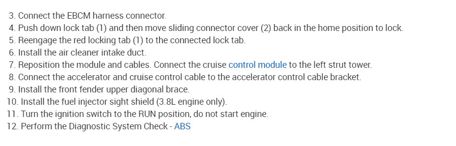

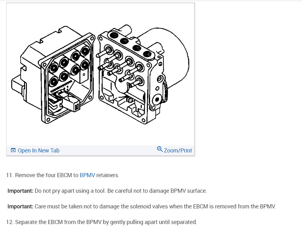

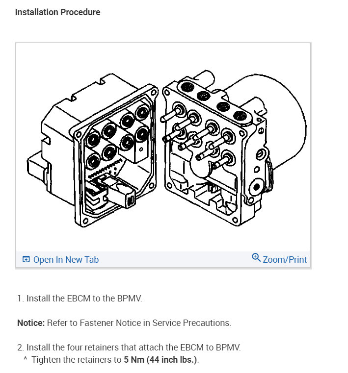

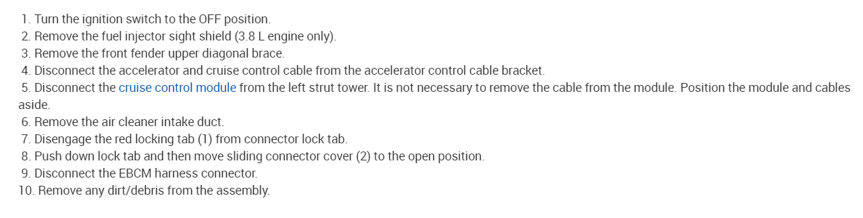

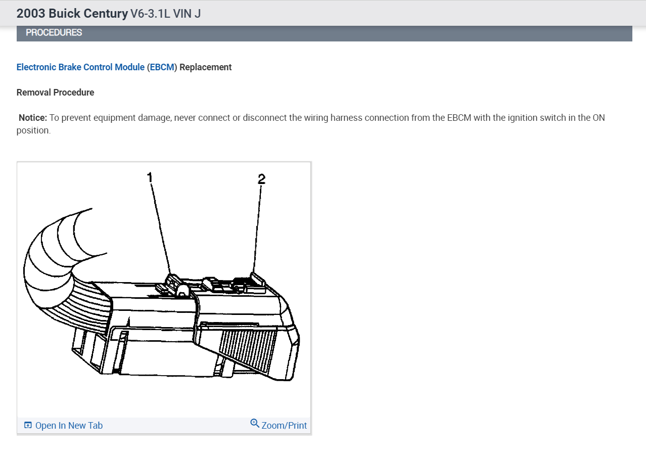

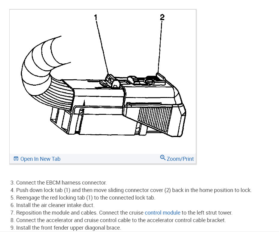

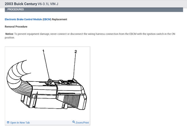

The fact that three out of the four corners are having an issue with the sensor I would say the ABS controller has gone bad, the reading for the sensors look normal. Here is how to change out the controller to see if this fixed the problem. The only other thing is if the ABS light has been on for years the hub bearing could be boing out on the respective corner. Here is a video of the job being done in a similar vehicle:
https://youtu.be/lUotkKXG9dY

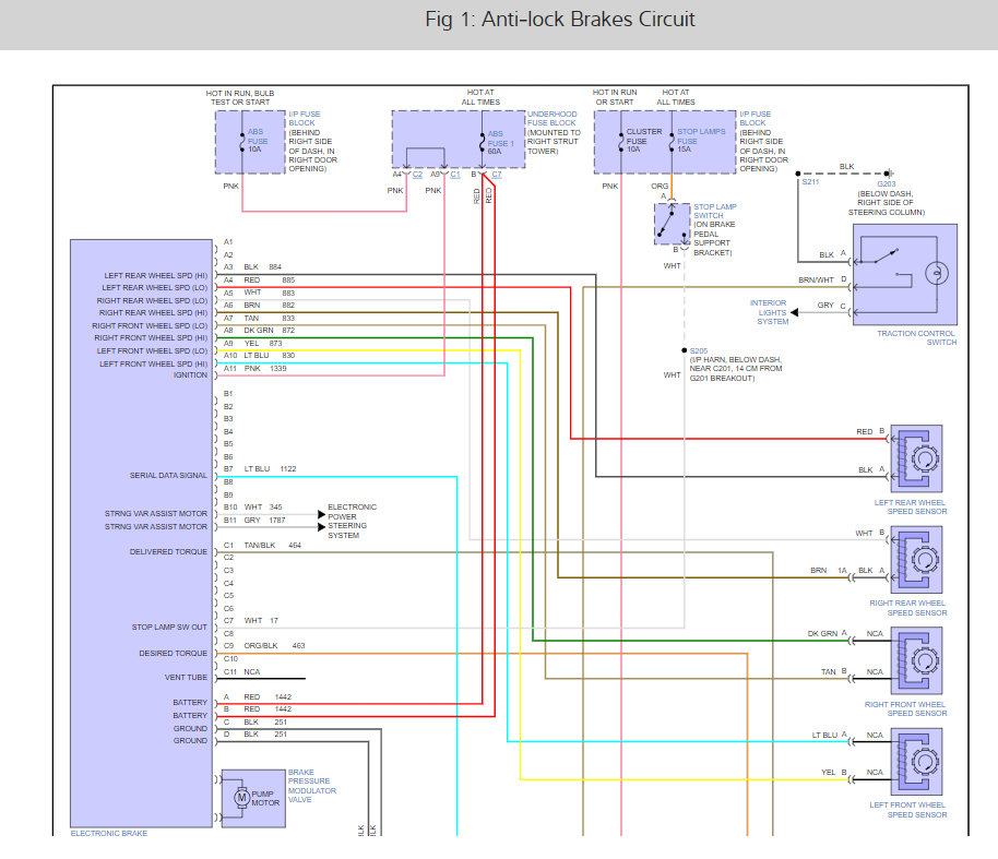

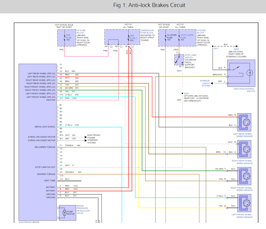

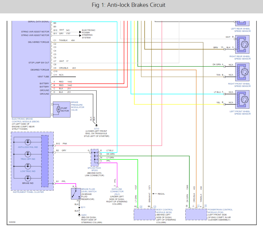

Bad wiring can cause issues like this for sure.
Here is the ABS system wiring diagrams and a guide on how to check the connections:
Check out the diagrams (below). Please let us know what you find.
