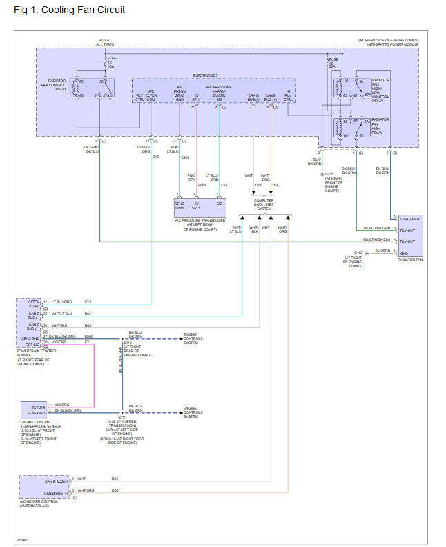

This is a rather complicated two speed fan system. I am not sure what you could possibly know about how the fan is operating while you are driving. There are a number of different situations that trigger fan operation at differing speeds. About the only reason a fan would kick on in a moving vehicle would be due to AC or defroster operation that engaged the AC compressor. There is a possibility you could be missing the low speed but you would need a bidirectional scan tool to test any of that. https://www.2carpros.com/images/external/212348198.jpg

Sorry, I gave you the wrong wiring diagram. Here is the correct one.
Dec 31, 2016 at 6:46 AM
