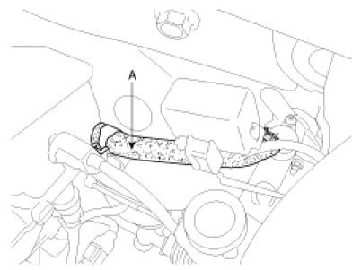

1. Loosen the bleeder screw(B) at the clutch release cylinder(A).
(pic 1)

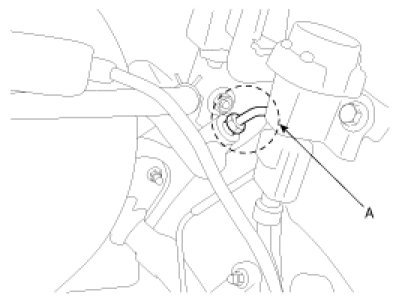

The rapidly-repeated operation of the clutch pedal in B-C range may disrupt the release cylinder's position. During the bleeding operation, press the clutch pedal to the floor after it returns to the "A" point.
(Pic 2)

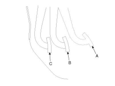

Drive the car until the problem occurs. At that point, open the bleeder on the clutch slave cylinder (picture 3) and see if there is a release of fluid allowing the clutch to fully engage.
If there is, suspect there is an issue between the slave and the clutch master cylinder. Repeat the process until it happens again. Then, loosen the same supply hose at the slave cylinder. If there is no release of the clutch, suspect the tube is bad or the flexible hose to the brake reserve tank and needs replaced. If there is a release, the problem is the clutch master cylinder.

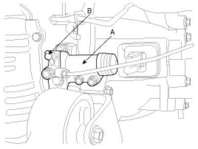

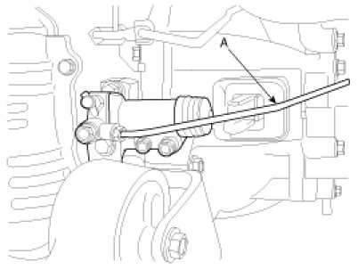

Picture 4 is the clutch master cylinder and picture 5 shows the flexible brake reserve tank hose.
