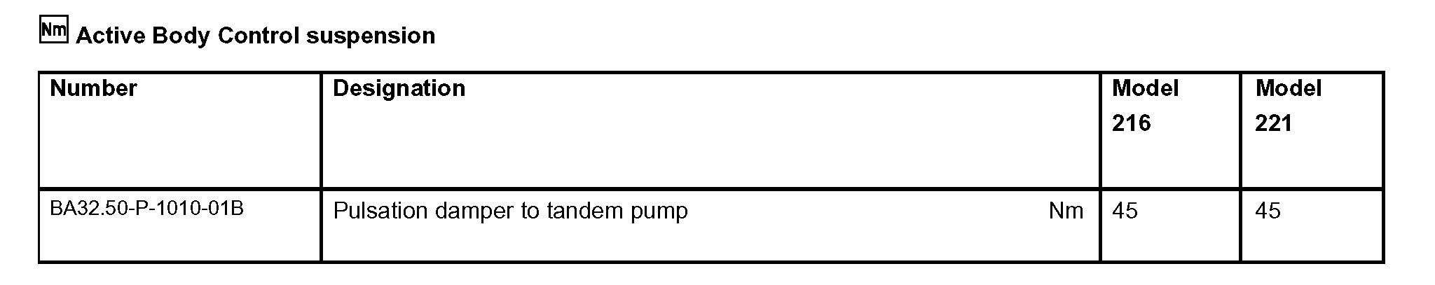

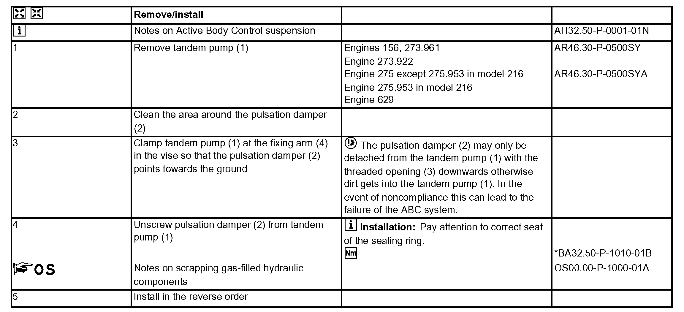

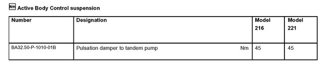

Does the pulsation damper on the ABC pump have a left or a right hand thread?
May 21, 2019 at 8:49 AM
Welcome to 2CarPros.

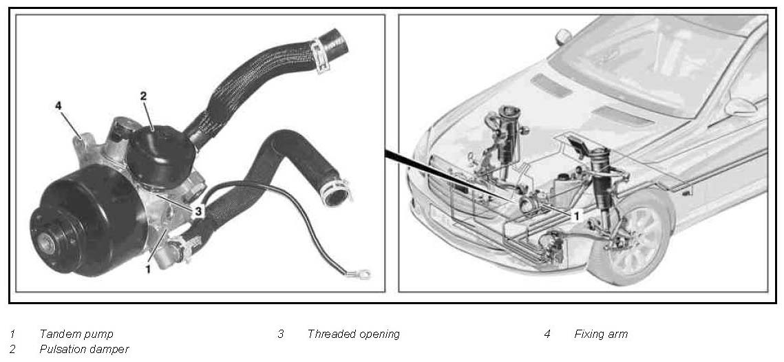

That is a standard left handed thread. The directions are included in the attached pictures.
AR32.50-P-0013SX REMOVE/INSTALL PULSATION DAMPER
AR32.50-P-0013SX Remove/install pulsation damper
- with CODE (487) Active Body-Control (ABC)
Component Identification

Remove/install Steps 1-5
picture 2
Active Body Control suspension
picture 3
