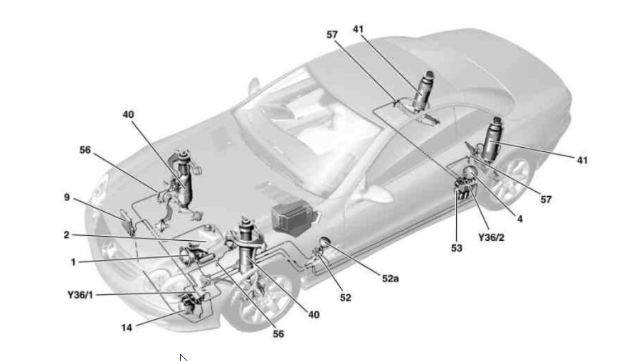

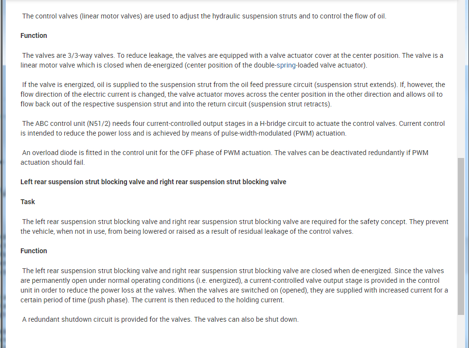

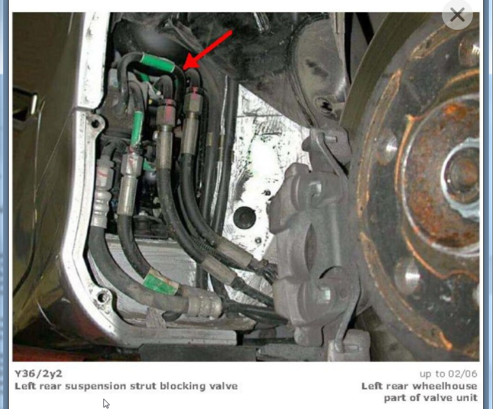

I replaced a weeping hydraulic hose and on restart the rear (left and right) bottomed out. I have flushed and bled the system. Front bleeders produce a spray and rear valve block line produces fluid at valve block, however when bleeder screws on LR and RR are opened, only a drop or so of fluid comes out. Flushed again while performing a rodeo with no change. I have used a Foxwell 510 elite to scan the suspension module and the results show that there is a "critical vehicle level" for both LR and RR. No other codes besides low voltage from battery Intermittent It shows that all four abc valve locks are open during live data scan. Sensors for both left and right font show voltage and bar measurements to be well within tolerance but the LR and RR show .56v-1.3v and 0-2 bars consistently from idle to rodeo. The ABC pressure shows 180-195 bar during all situations and never below 178. During rodeo the rear does attempt to move up but only about 1/2 inch. Measurements from ground to apex of wheel well LF 28.5 in. RF 28 in. LR 25.5 in. RR 25.75 in. Please help me. The men with the nets and funny jacket are already here for me.
