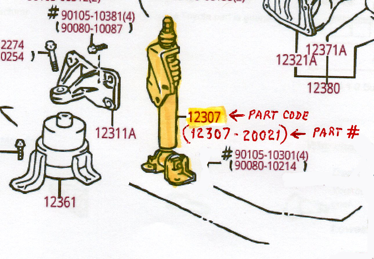

The picture of that part is attached.
Its Toyota original number is 12307-20021, part code 12307.
That motor mount is also called "Engine Shock".
But as I remember, the cylinder and piston of that part were
moving freely up and down without any resistance.
That is not the behavior of shock absorber.
So I will study other equivalent parts for shock absorbing operation (Auto parts Stores and Dealer's place) and will do a new replacement if needed.
