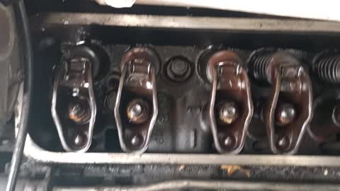

It might not be the best video but if it's not good enough let me know and I will record another video.
Sep 2, 2023 at 9:11 PM

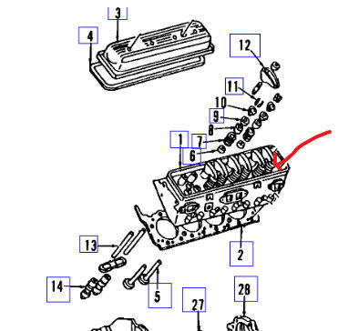

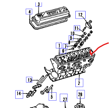

Thanks for the video. it does sound like a broken valve spring, or the valve train has fallen apart, you can remove the valve covers for an inspection. Use a flashlight it helps with the inspection. Please check the image below to see what I am talking about.

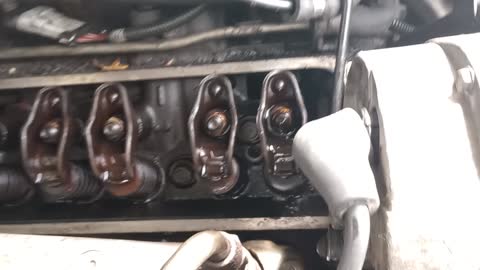

There is a lot of oil shooting out of the 1 and the 3rd on in the passenger side going from right to left.
Sep 13, 2023 at 1:09 PM
Wow, you are not kidding, thanks for the video. It looks like the engine has a spun bearing which is affecting the oiling of the engine and making the noise. You are going to need to remove the engine and disassemble it to find the problem.
