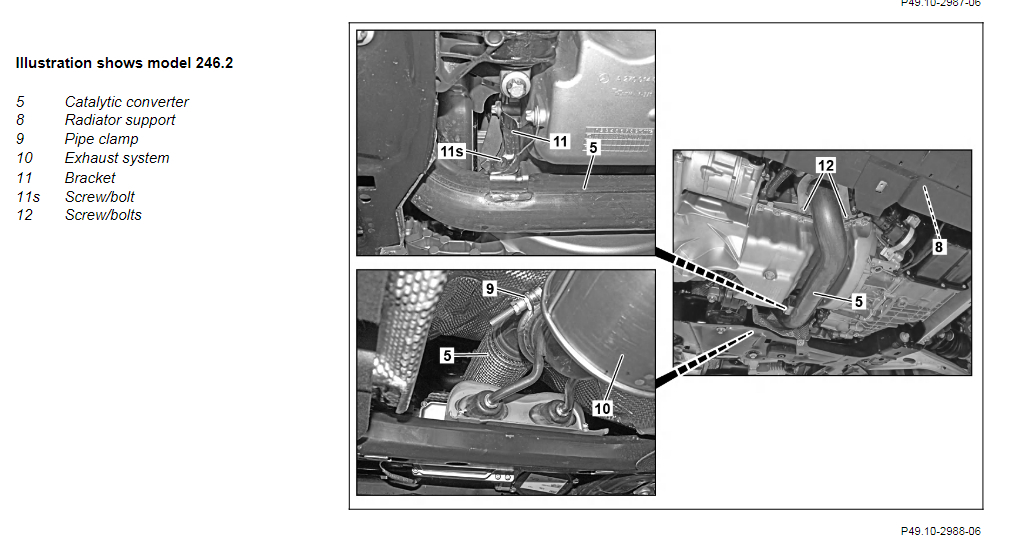

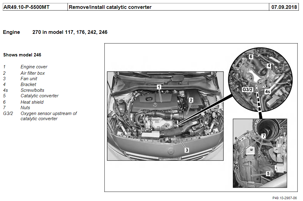

Thanks for the videos, they help. I don't think this is the transmission especially when it is working okay. To me it sounds like you have a primary catalytic converter that has fallen apart internally. Please check out the images below to show you how to remove it for inspection. Check out the images (below). Please upload pictures or videos in your response of any problems so we can see what to help you with.
