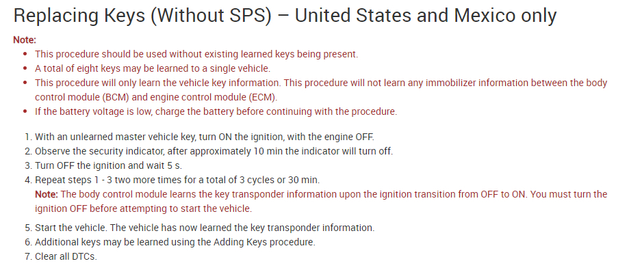

So, I have the car listed above and my ex decided to break and throw my only key I had. so, I got a dealer cut one and I’m not sure how to reprogram it myself. he had also cut the exhaust off and I’m not sure if that’ll put it into auto theft deterrent mode but that’s also on.
