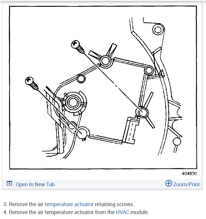

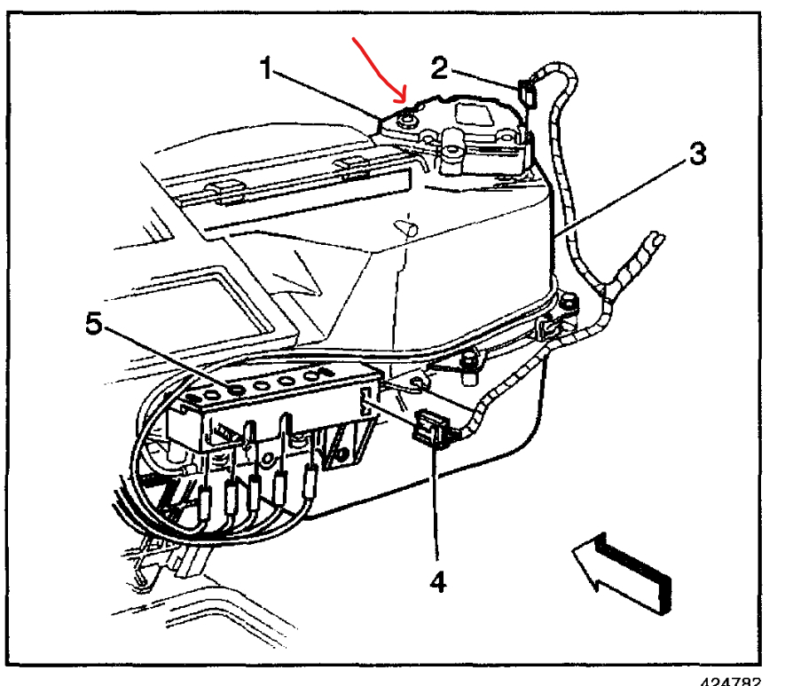

Here is the location of the temperature blend door actuator so we can be on the same page. Also, the actuator must be calibrated:
Use the following steps to perform the calibration update:
1. Turn OFF the ignition.
2. Remove the battery positive voltage circuit fuse of the HVAC Control Module.
IMPORTANT: The module memory will not clear if the battery positive voltage circuit fuse is installed in less than 60 seconds.
3. Wait 60 seconds.
4. Install the fuse.
Check out the images (below). Please upload pictures or videos in your response to any problems so we can see what to help you with.
