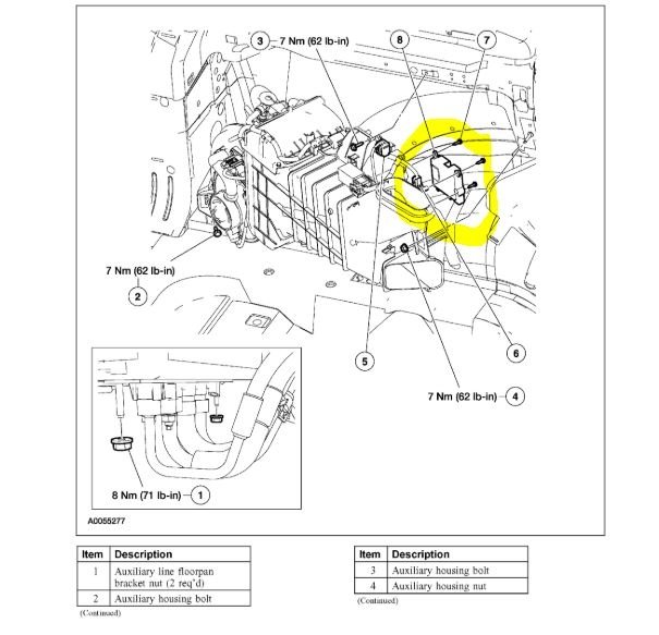

This sounds like you have a vacuum leak to the motors inside the truck. They used vacuum motors to control mode doors and electric for the blend doors.
I attached a picture for the rear blend door for you.
Remove the left rear quarter cover inside the truck and it is right there.
Look under the hood for any broken or loose vacuum lines on the passenger side where the line comes through the firewall.
