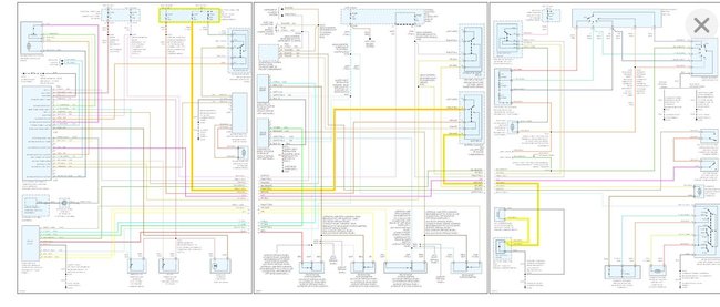

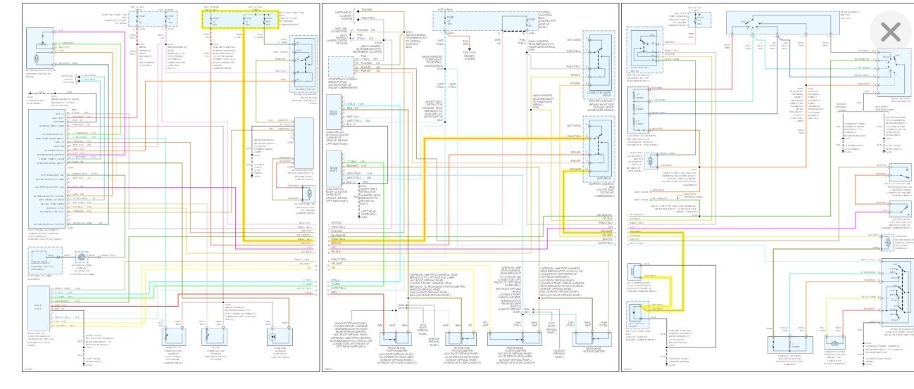

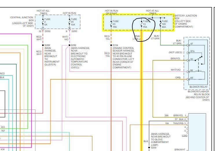

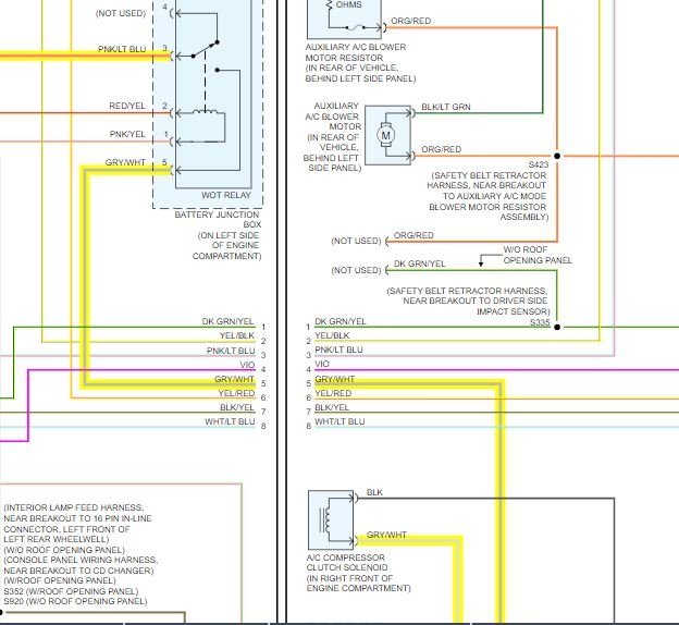

I attached a diagram for you. Check the fuse circled for power on both sides.

Thank you for your response. I recently serviced my A/C system and went for a test drive. The engine temperature was almost red lined while running the A/C system. I turn it off and my temperature came back down, after I got home I turned the A/C system back on and realized my compressor was never turning off. I read somewhere that to replace the low pressure switch the system needed to be emptied. So I had that done and replaced the switch, now it does not come on at all. I checked the fuse and the relay and there both okay.

I had to jump the low pressure switch to get power at the compressor. Doing so made the compressor turn on but the system will not pull the Freon into the system. The low pressure and high readings jump to 95 psi both.
