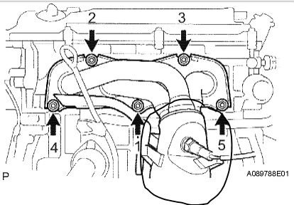

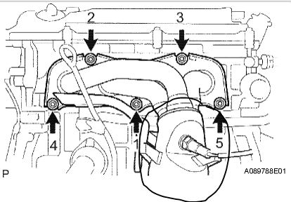

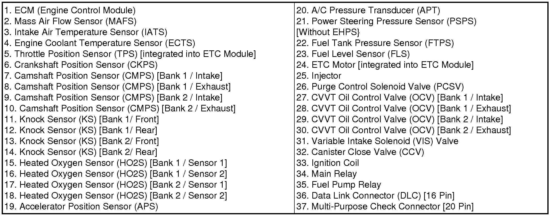

Okay, there is a chance these are related. So, lets start with the coolant temperature sensor. See pic 1 for sensor location and picture 2 for a legend of components. I did circle the sensor in picture 1 to help locate it.

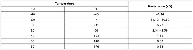

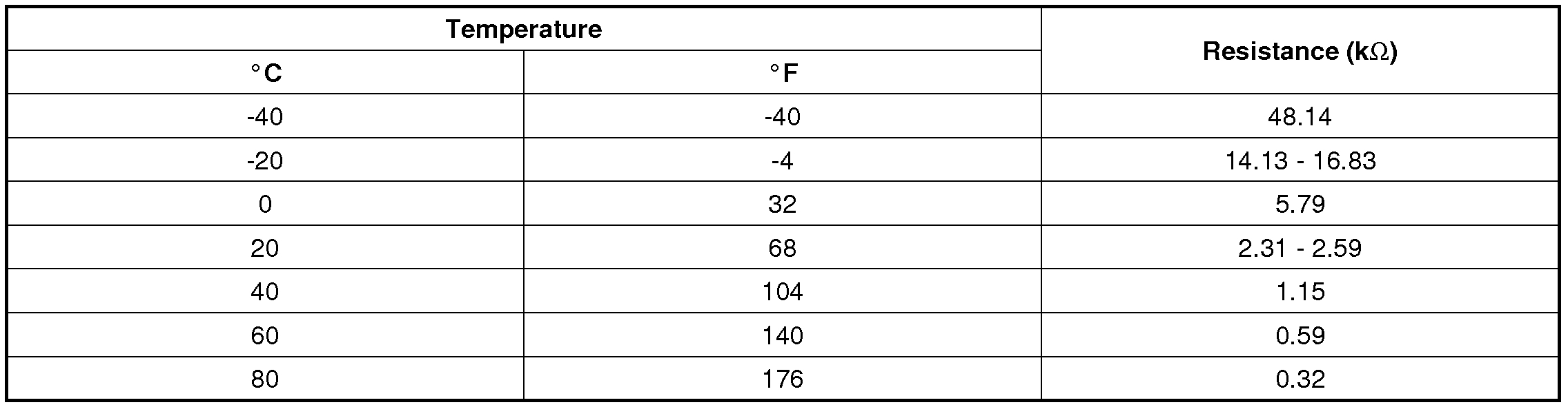

5. Check that the resistance is within the specification. See pic 3
