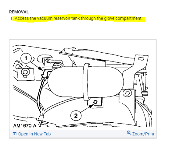

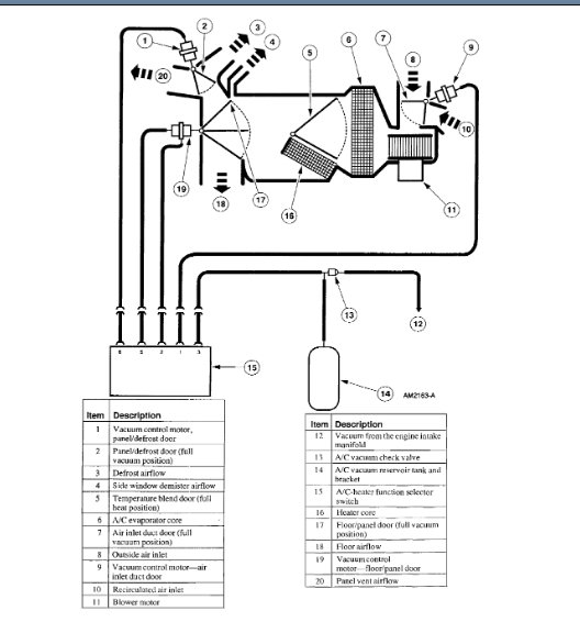

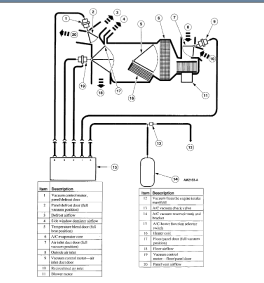

I found a vacuum schematic and attached it below. The check valve is number 13 in the pic. Note number 12 is the source (engine). From there, the vacuum hose is routed into the vehicle behind the glove box. Behind the glove box is the vacuum reservoir. I believe you will find the check valve right before the reservoir.
Sorry. It's been a while since I had one of these apart, and the manuals are not very specific.
Let me know if you are able to find it.
