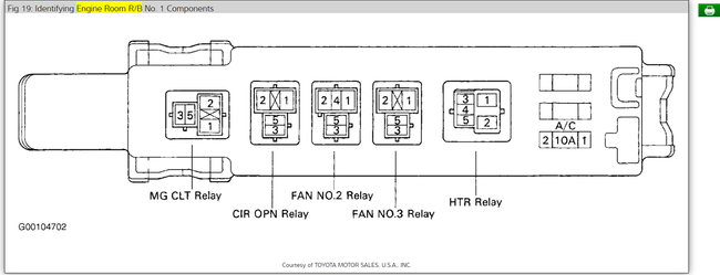

No MGC operating. Air conditioner not working
Feb 22, 2019 at 2:52 AM
CERTIFIED EXPERT
53,855 POSTS

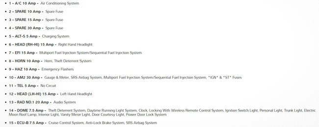

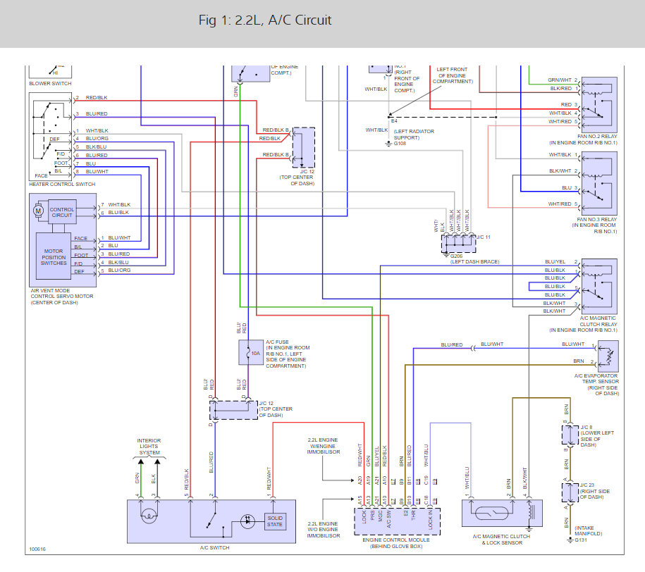

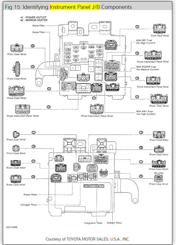

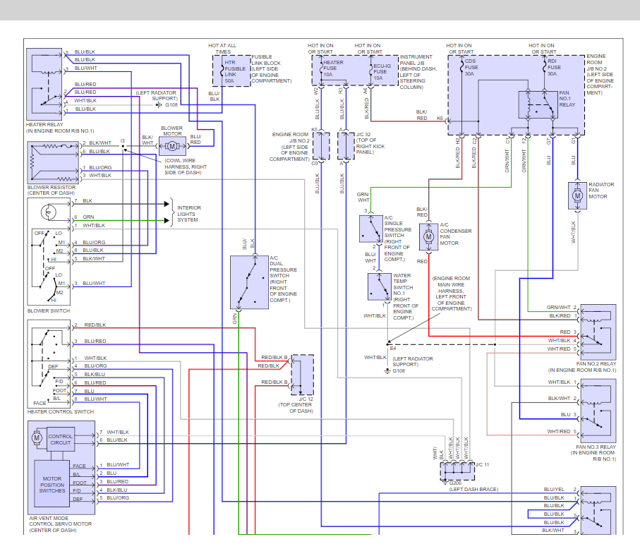

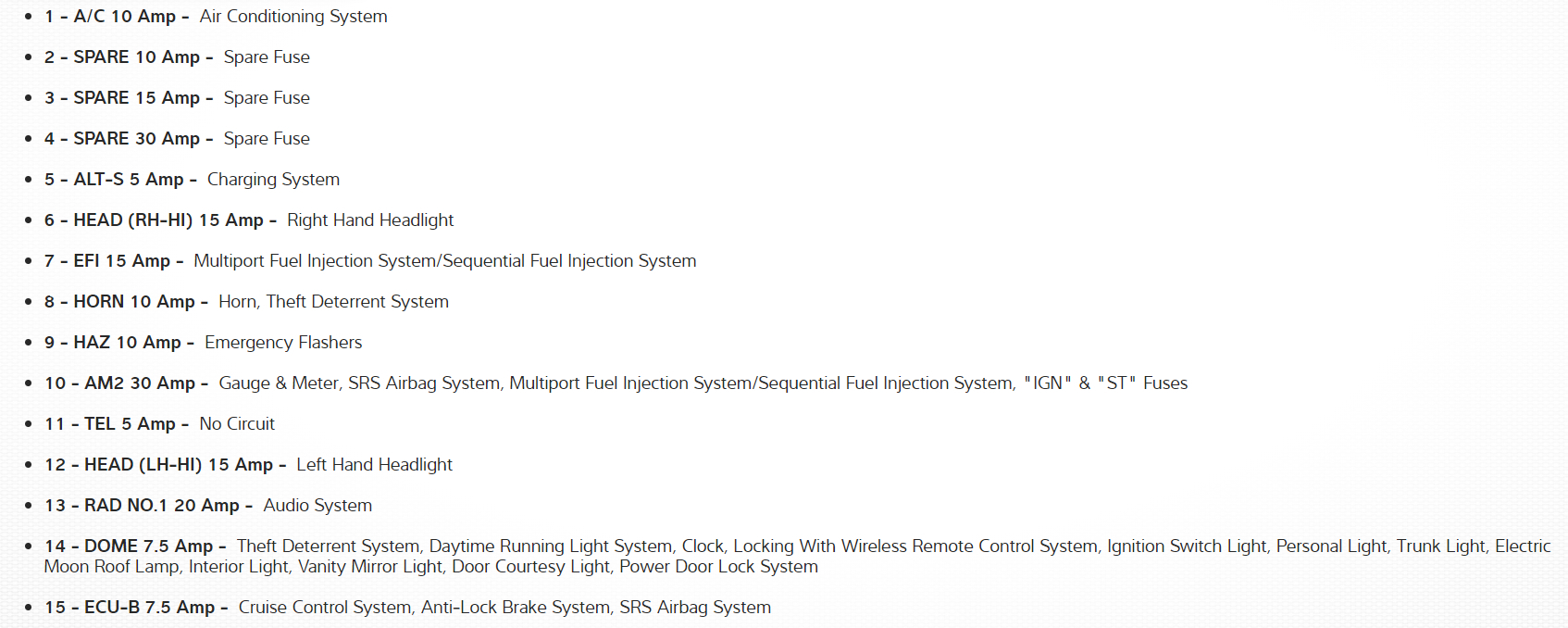

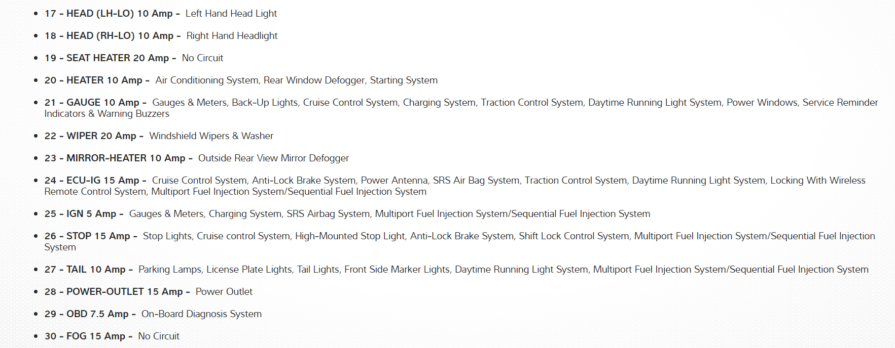

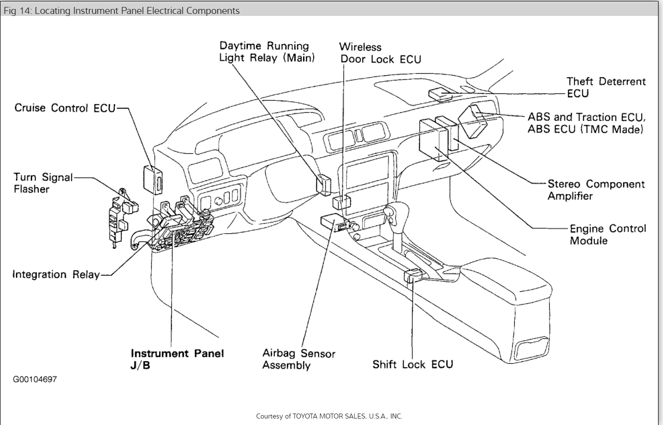

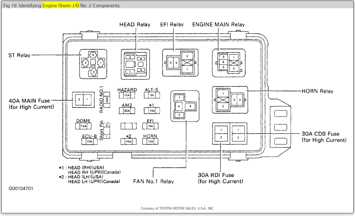

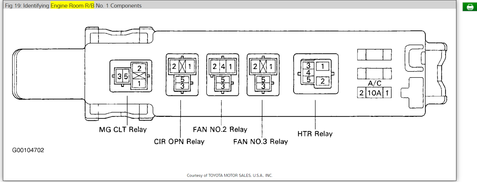

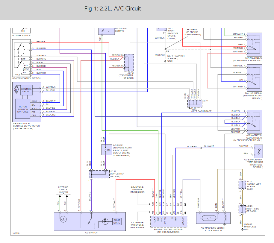

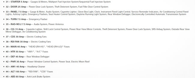

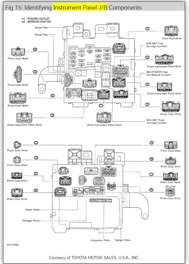

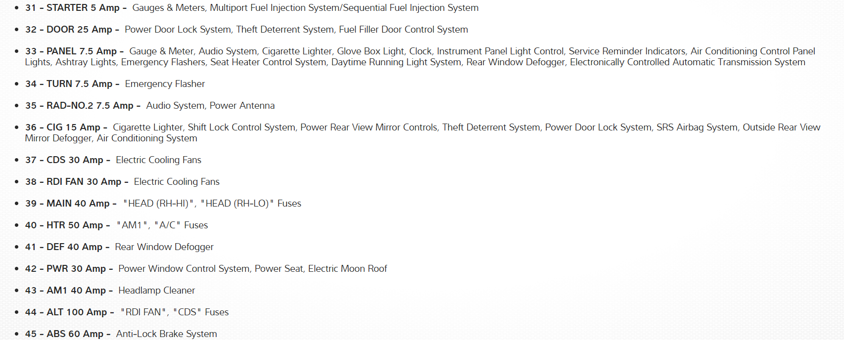

This can be because a fuse is blown. Here is a guide to help check for power and the air conditioner wiring diagrams so you can see how the system works and what fuses to check:
Check out the diagrams (below). Please let us know what you find.
