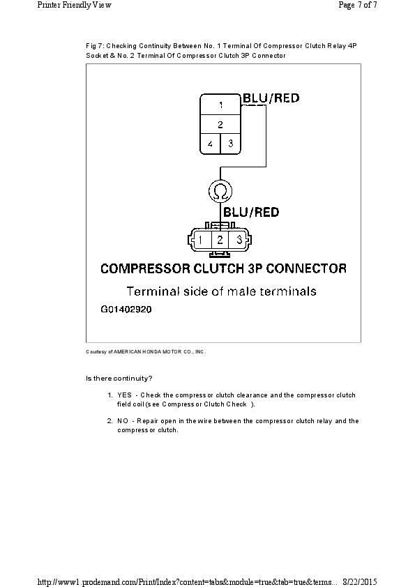

Hi yes I use it often it can turn off in traffic or driving on the highway can you give me the ohms range for the electromagnet and the gap for the clutch thanks for your help it is greatly appreciated Neil
Aug 22, 2015 at 3:41 AM
RIVERMIKERAT
  • 6,110 POSTS
Try this.
Aug 22, 2015 at 6:04 AM
RIVERMIKERAT
  • 6,110 POSTS
Damn. Wrong button.
NEIL2002CIVIC
  • 119 POSTS
Hii did continuity test it was good but a/c was working at the time does it have to be not working when I check it? Do I go to the next step clutch gap/clearance? If so what is the clearance gap?
Aug 24, 2015 at 5:34 PM
RIVERMIKERAT
  • 6,110 POSTS
Yes. When it conks out. Also check to see if the relays are passing power.
.02 +/- .006 in according to my reference.
.5 +/- .15 mm

Stooped working twice ,by the time I hooked up the meter less then 10 minutes it checked good my gut feeling is the magnetic coil ii s going bad what is the ohms reading in it? Its hard to figure out when it is so intermittent
Sep 1, 2015 at 7:56 AM
RIVERMIKERAT
  • 6,110 POSTS
It's not listed in the diagnostic steps I sent?
