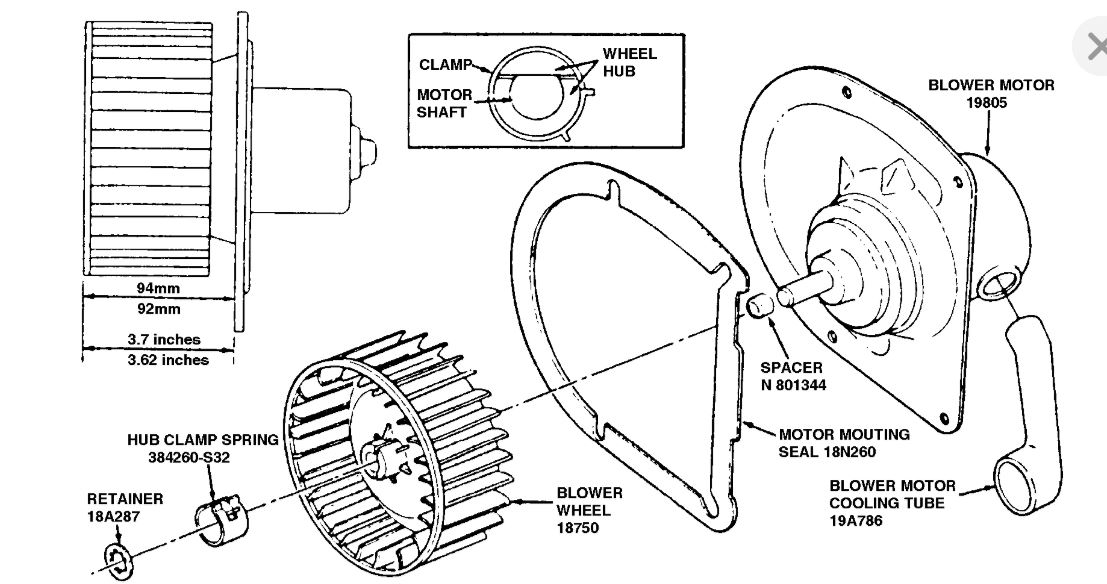

I would start by checking the connection at the blower motor itself. It is common for this to be hot and bad connection results.
https://www.2carpros.com/articles/blower-fan-motor-works-on-high-speed-only

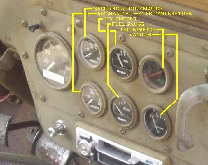

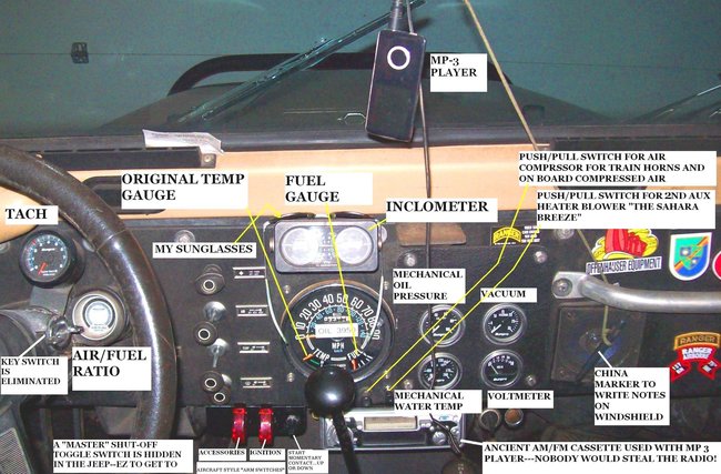

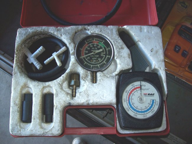

A vacuum gauge hooked to the intake and ran back into the cockpit might show what the actual vacuum is when this is happening.
I have a "shop gauge" for tuning and one mounted on each of my Jeep dashes. Vacuum gauges are great diagnostic tools for an engine before tearing into one!
Here is a guide for vacuum leaks:
