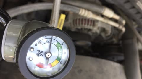

No A/C this morning. Saw that A/C clutch was not engaging.
Got some 134a (pressure was very low); added up to about 50.
Now clutch is cycling on and off. When clutch engages pressure drops to about 10. Clutch disengages. With clutch off pressure over 2- or 3-seconds climbs back to about 50. Clutch engages.
Pressure drops again. Rinse/repeat.

Thanks, Al! I tried to upload a short video of the clutch cycling, but obviously it didn't work. No way 8 seconds per cycle. Clutch comes on for maybe 1 or 2 seconds. Pressure simultaneously drops to ~10. Clutch disengages. Pressure builds back to 45 or 50 over the next 3 seconds. And the cycle repeats.
After waiting a day since Freon charge I went out to see if there was still ~45 or 50psi. Nope. So, there is a significant leak and I'll have to take the old truck to an A/C pro.
I was thinking and would like to ask after watching your "detect a leak" video, I thought maybe I would get a can of dye and see if it points to where the leak is (then maybe replace whatever is needed before going to the pro). Good idea or bad? Does the can of dye do anything to gum up the system?

I really appreciate your help, Al. Unfortunately, after soapy-water spraying every fitting, behind the clutch, connections, core (all over, including sides), the sensors --- no bubbles. Soapy water trick does work. I have a small natural gas leak out at the meter and for yucks sprayed those fittings, and sure enough, bubbled up. But couldn't find a thing on the truck. Maybe the compressor isn't staying on long enough to build pressure to show leaks?
Here's my little 10-second video - you can see the clutch on the left, corresponding with PSI changes.

Looks like there might be too much air in the system, air is much more compressible than Freon is. If it's cycling that fast it's not building enough pressure to do anything really, did you try spraying the whole front condenser?
You can try putting some more Freon in, but you have a big leak if it's empty overnight so I wouldn't waste the money on Freon that's just going to leak right out. It will need to go to a shop for the system to be vacuumed down and recharged anyway. What you can do is have them call you before they do any repairs. If they call after they find the leak, then you will at least know how much the repair will be. If it's a faulty compressor, it can be quite expensive. With a failed compressor the whole system needs to be cleaned out, the receiver dryer needs to be replaced, the lines need to be cleaned just in case there's particles from the failed compressor, etc.
Thats what I would do so you don't go to pick it up and get a huge bill you're not prepared for. Especially with a big leak, it might be the condenser on the front of the vehicle, and those can be costly as well. So have them call you after they find a leak and give you an estimate for the word. Just to cover yourself.
Also take it to a shop you trust. I hear too many stories of people being taken advantage of and it's just wrong. Hope it all goes well for you. And let us know what you find.

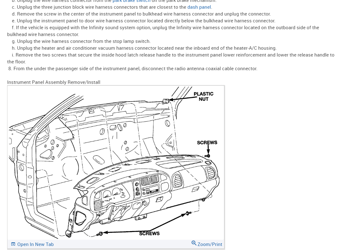

Me too, that's the worst place. Thats why i'd have them call you first, the bill for that might be too much. I'll take a look and see what needs to come out if the evaporator is leaking,
What size engine is in this, and is this a pickup or van? Dodge has listed a Ram Van and Ram Wagon as well.
Anyway, it looks like the whole dash has to come out to get the HVAC box/housing out. It's a big job.
