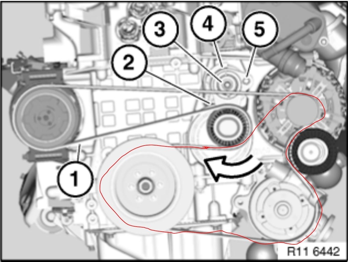

Got the car from an auction, had to buy a key fob for the car to see if it would start. No serpentine belt, all pulleys spin except the air compressor pulley. Way too expensive to fix right now $1,200.00 compressor $700.00 labor. Out of money to do all that right now, but would like to be able to drive it some. Does anyone on here know if a bypass belt can be used on this model with the inline 6 cylinder? Also a belt size and the new routing to put the new belt on? Desperately seeking knowledge. Please can someone help me?

If you wanted to bypass it then finding the right belt will be the hardest part, it would need to run on the red line on the image. To get a close size to start you would need to use a wrench to move the tensioner in the direction of the arrow and place a lock pin in the hole at number 5. Then take something like a cheap tie strap or something else that is flexible and wide enough to cover at least half of the pulley. Run it around the pulleys and idler on the red line and secure it, now take that to a parts store and see if you can match it to an existing belt with the correct number of ribs.
