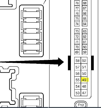

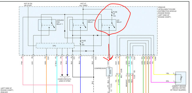

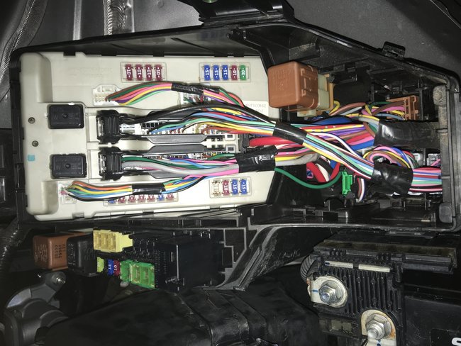

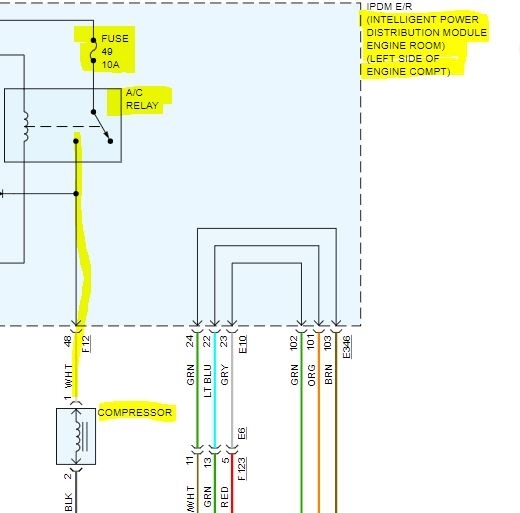

The A/C stopped working so I checked for leaks. It doesn’t have any. Changed the A/C compressor and add coolant but it’s still blowing hot air. Is the a relay I can check? If so where is it located?
