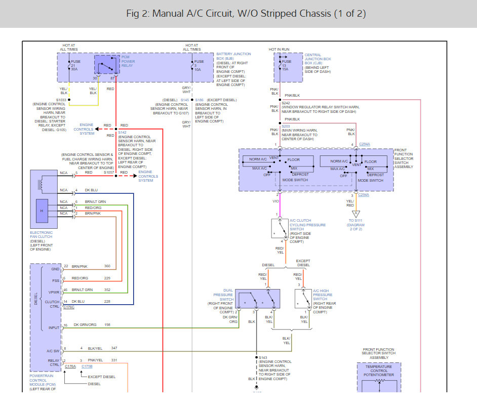

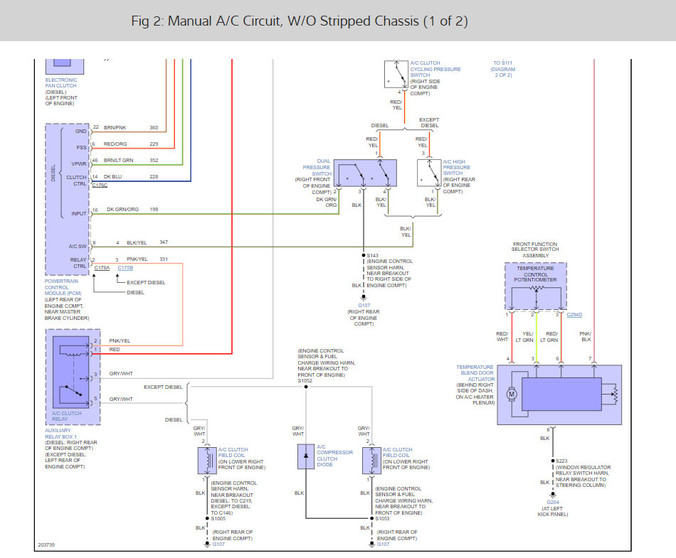

Yes, the PCM monitors several items to control the engine speed, does the system have pressure enough to activate the pressure sensors? Here are the air conditioner wiring diagrams, as you can see there is not too much to the system, I would check the dual pressure and high-pressure sensors. Is this a diesel by chance? If so, there is an electrical fan clutch which if it is not working the A/C will not come on. Check out the diagrams (below). Please let us know what happens.

That diagram is consistent with what i have. provided pin 4 blk/yl gets 12v + the PCM should supply a ground to pk/yl pin 3, which clicks the relay and allows power to go to the clutch on a gray/white wire coming from another gray/white wire that is fused. fuse compartment 1 fuse 3, AC/daytime running lights. This circuitry and every connector have continuity. The PCM is not supplying a ground. The PCM is stupid, whether there's pressure in the system or not if the low and high pressure switch connectors are jumpered with a u-shaped piece of wire 12 volts will go to the PCM and show a demand.

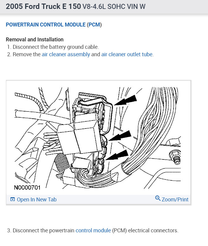

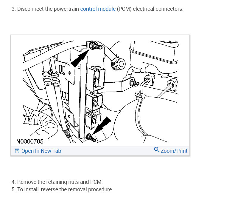

PCM's do go out, it looks like that is the problem. here is how to replace the unit in the diagrams below. It is easy to replace because it is plug and play, I would try a used one to save money. Check out the diagrams (below). Please let us know what you find.
