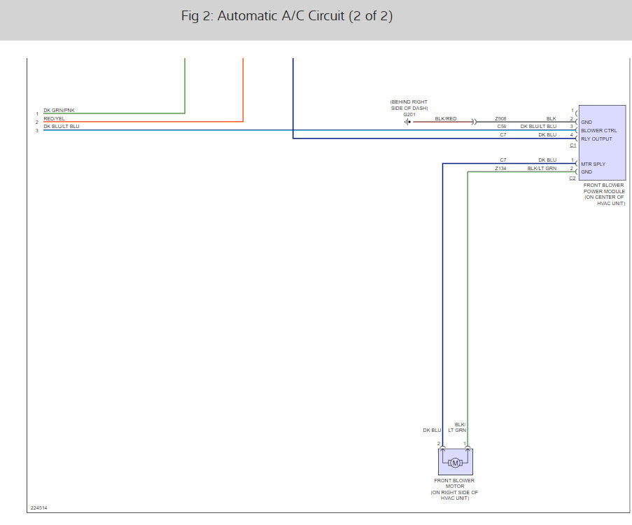

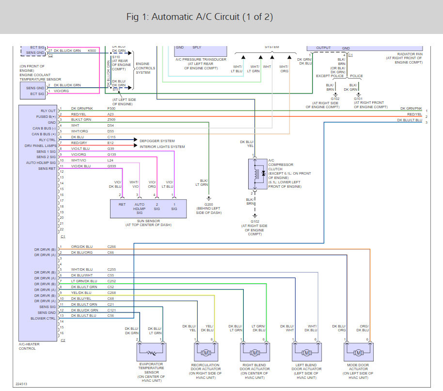

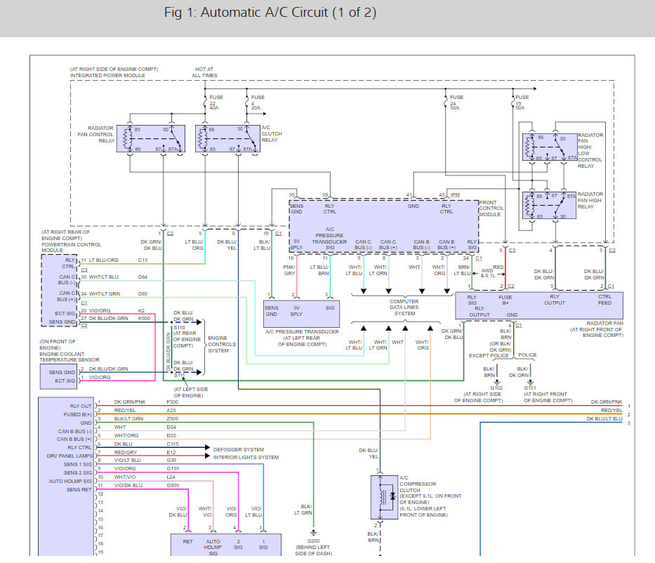

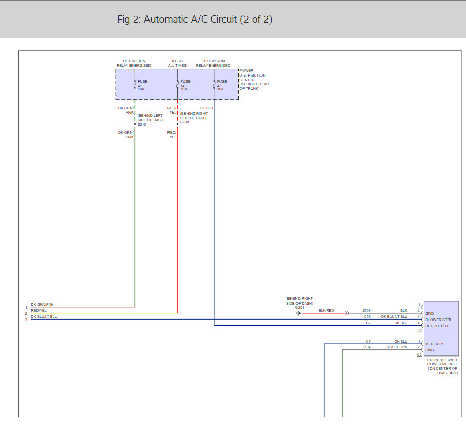

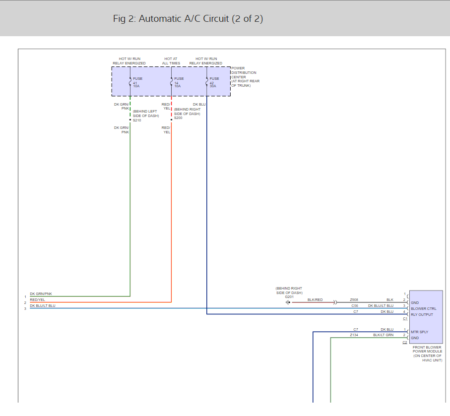

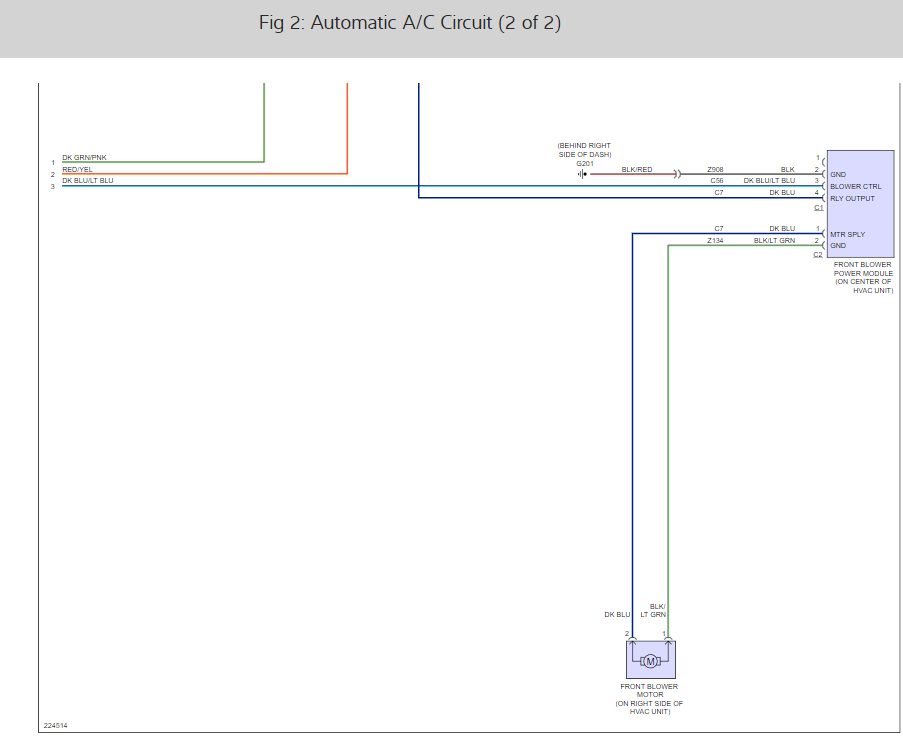

Back? Does this car have rear AC? Here is the wiring diagrams for the system and I do not see one? Can you shoot a picture and upload it here so I can see what you are talking about?
Check out the diagrams (below). Please let us know what you find.
