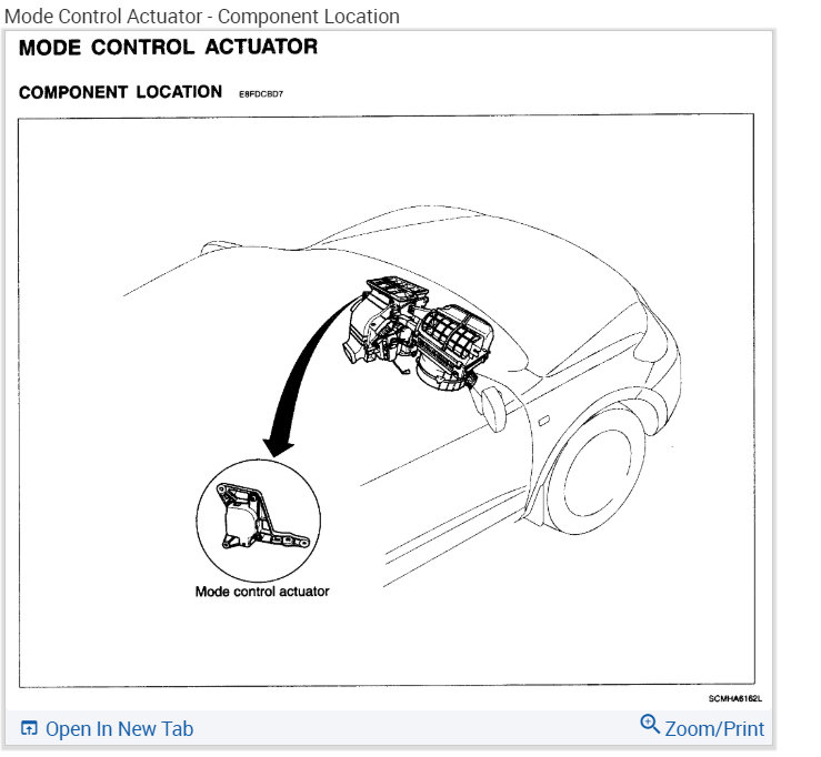

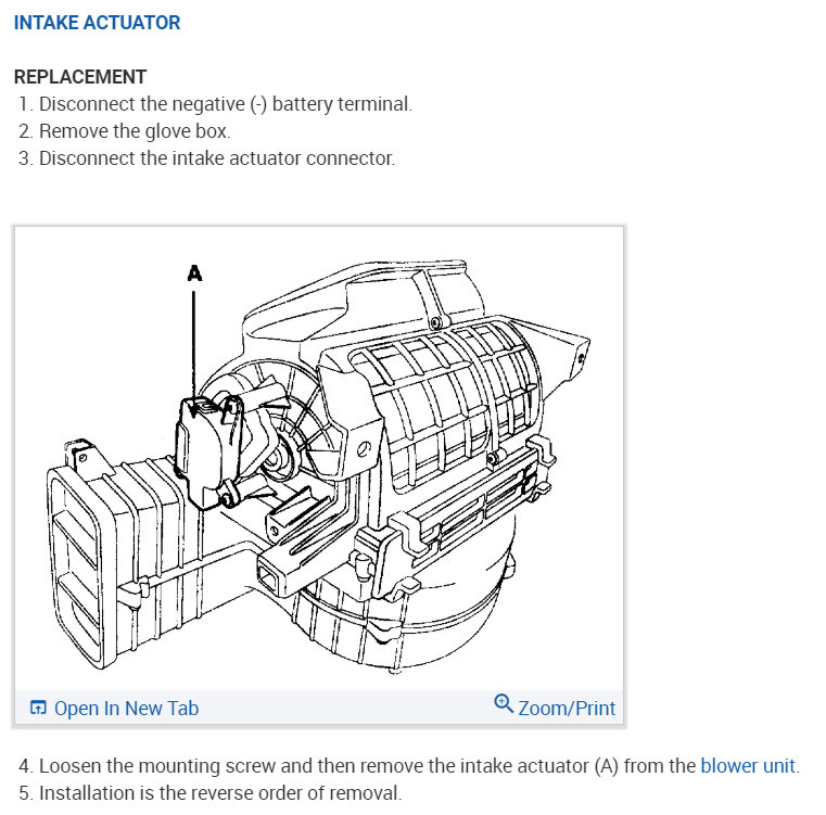

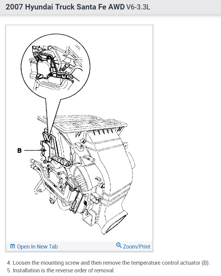

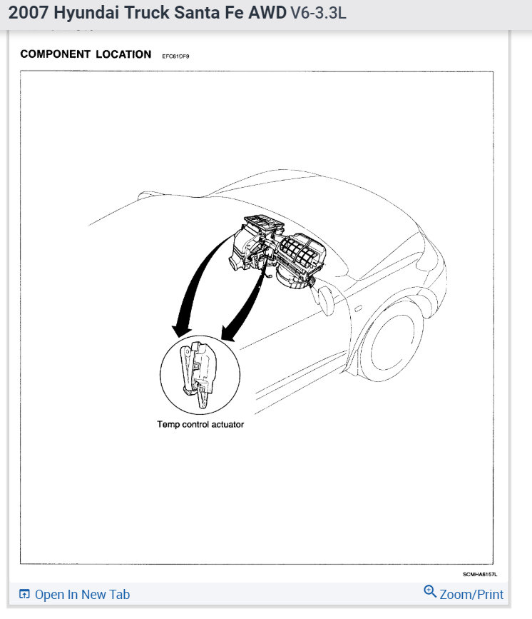

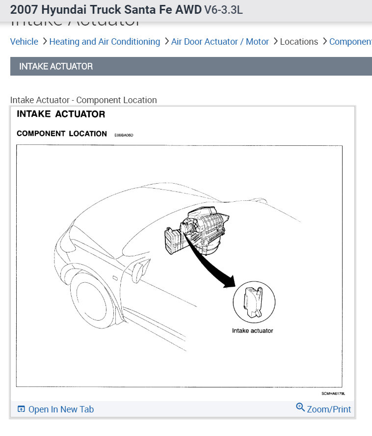

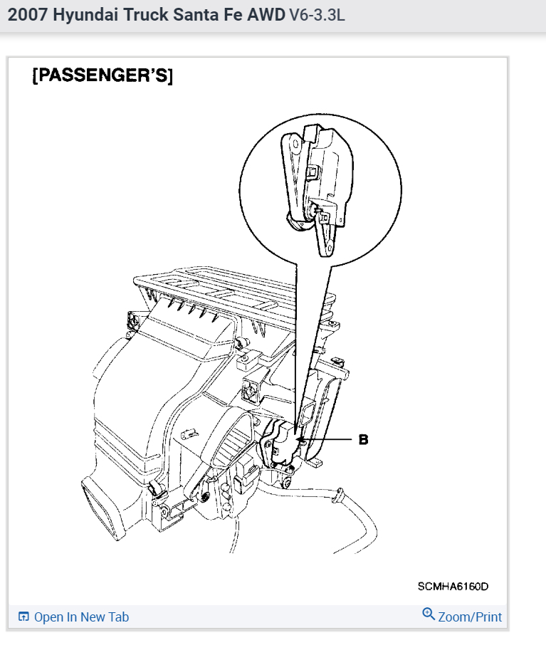

If the actuator is moving that could mean inside the plenum the door that divert the air has come undone. To be sure lets remove the actuator and move the pivot by hand to confirm. Here is a guide that will help also I have included the other blend door actuator locations so you can see how the system works:
