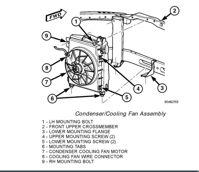

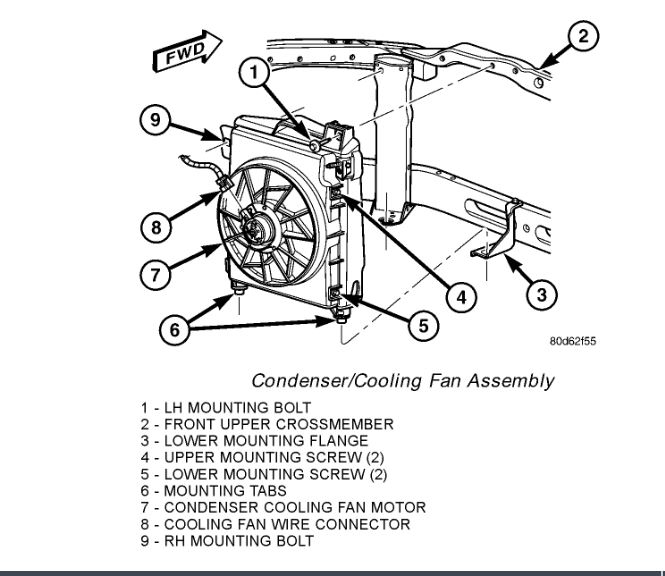

Is that the low side or the high side? I would like both readings if possible.
Is the cooling fan working when you are stopped? It has to be on to draw air through the condenser to cool off the Freon.
