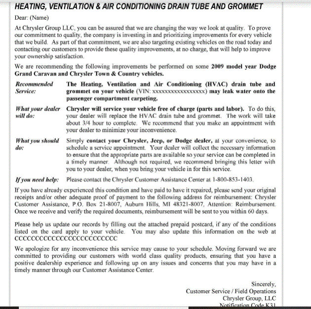

I would try turning off the system the see if it works after about 10 minutes.
Also look for water draining out the bottom. If that drain is blocked, it will cause this issue.
apparently, they have issues with this tube. I attached the letter for you to view. They are replacing this tube free of charge for you.
