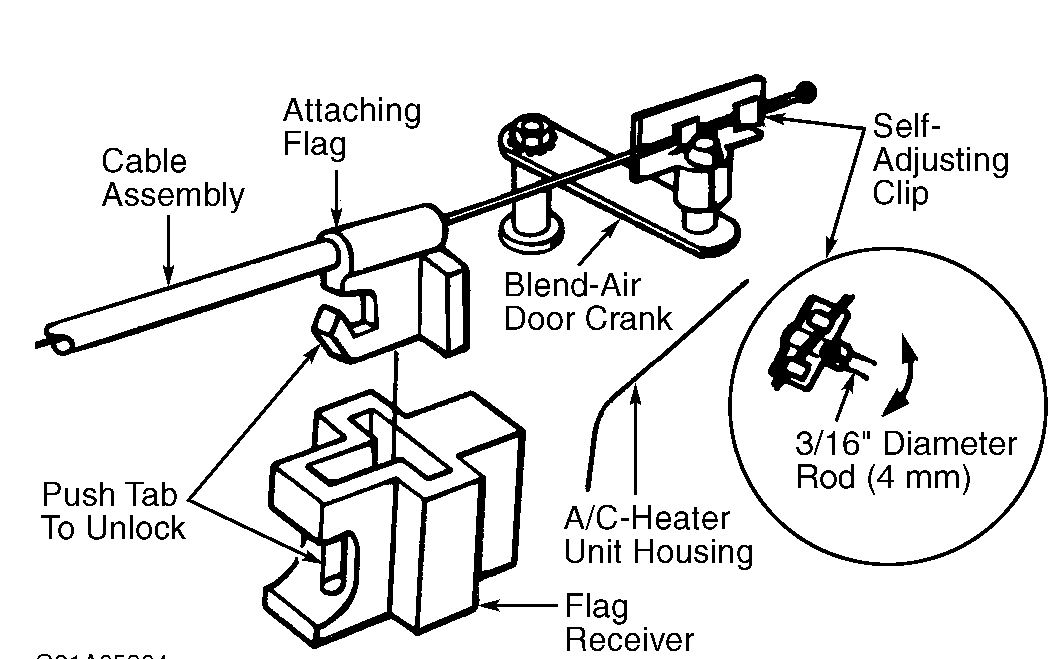

From your description it sounds like a stuck blend door. The mode selector sounds like it's okay as you can send air out the floor, dash and defrost. The cold lines should mean the actual A/C system is working, you just are not getting the cold air through the HVAC doors. On that truck it should be a manual cable control for hot and cold. However it isn't fun to get at the cable on the door end, you have to remove the dash to get to the clip that holds the cable to the door crank.
However you might want to pull the heater control out first just to make sure that the cable didn't fail on that end first. To do that you remove the dash trim then the 4 screws that hold the control in place. Then pull the control out and you should see the clip that holds the cable in place. Try moving the control and see if the cable moves. If it does the other end has either broken or more common it has slid in the clip.

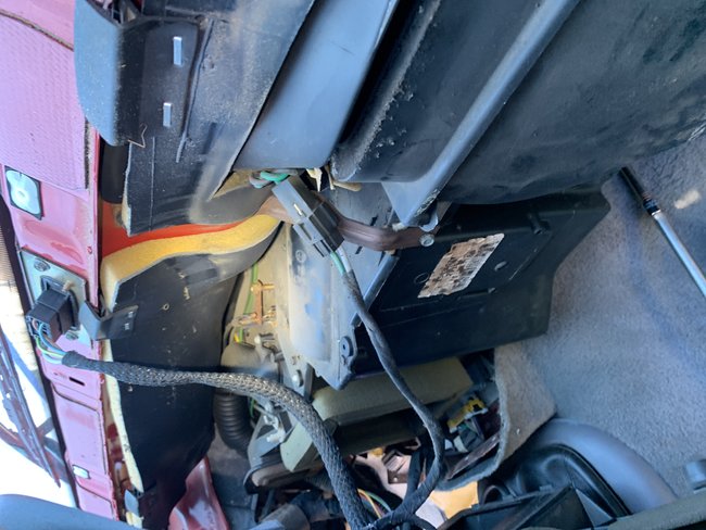

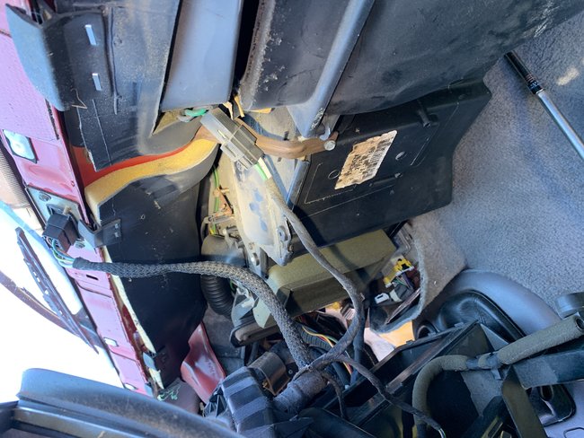

Well, got it to where I can see the blend control.

Only one door. Hard to see in the images but it looks like the lever is moving, if that is the case but you still don't get cold air then it may be the door itself is bad or something got in between the door and evaporator and is blocking the airflow. That would mean you need to open the HVAC housing itself to check the door itself, or slip a camera into the housing and use it to look at the door and the cores.

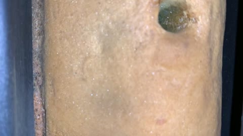

Okay, this is what I’m seeing:

Well, that looks like the entire door. Air should be moving across the core with that. Verify that it's fully closed but it looks like it is. To do that you rotate the temp to full cold, then move the door lever so it's at full cold. Once set that is all that controls hot and cold on them. I don't recall if you can run the blower with it apart, but you might want to run a set of jumper leads over to the blower motor and double check that the air is going through the cores properly. I don't really see anything wrong in that video but if the core is getting cold the air should get cold as well.
