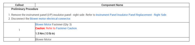

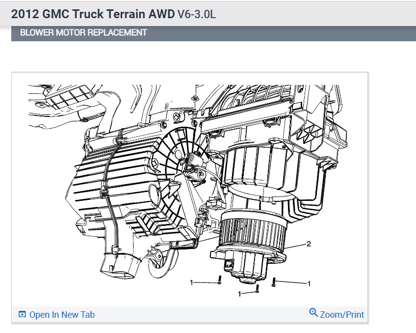

A/C and heater aren't working when i turn it on but as long as it is on and circulating from the outside and I'm driving i have a small amount of airflow. when i stop i have nothing. Before it started this i was experiencing a knocking like sound when i would turn it on, and the pressure of air coming out of the vents would fluctuate even when it was on high.
