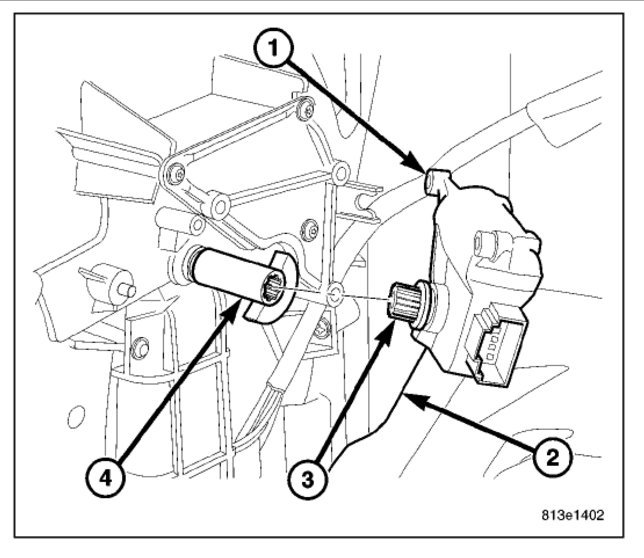

Just had my A/C vacuumed and recharged. Driver side is blowing cold, but passenger is not blowing cold. Could it possibly be blender doors? It should not loose Freon this fast and no notice of a leak I would think. Am I wrong?
May 11, 2017 at 1:54 PM

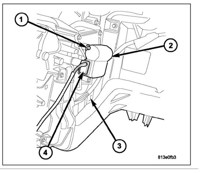

Yes the blend door actuator has gone bad which is located under the dash here is a diagram (BELOW) and a guide to help you get the problem fixed.
May 13, 2017 at 5:54 PM
