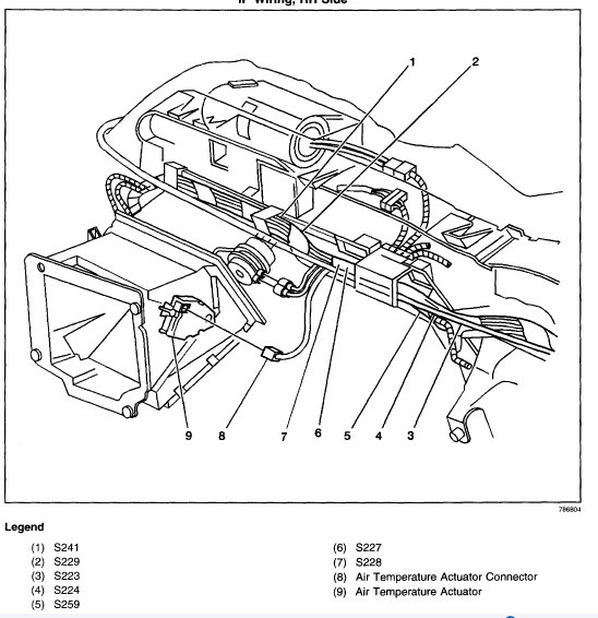

I was told at an auto parts store the next thing to check is the AC Heater Blend Door Actuator.
Does anyone know where it is? Or perhaps what the next thing to check is?
