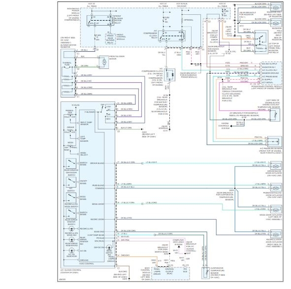

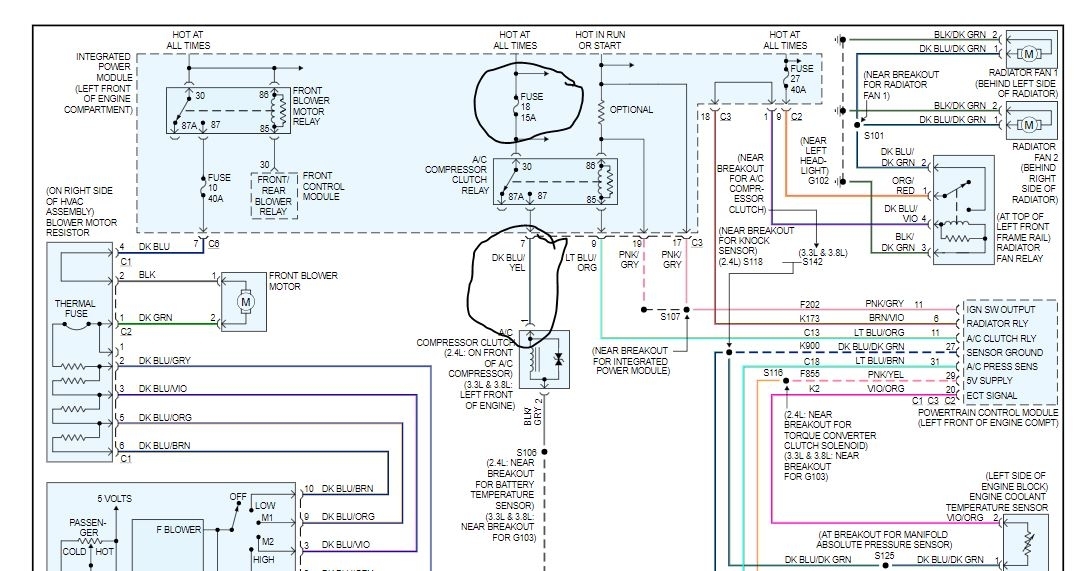

No fault codes. No blinking lights or indication of a fault. I ran calibration test. No blinking lights or fault codes after. I ran cool down test. Also no blinking lights or fault codes. At the end of cool down test the compressor light was turned off.
