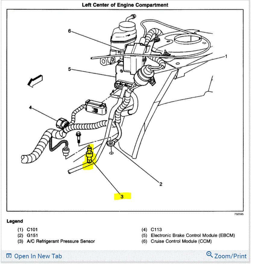

Where is the A/C low pressure switch located? cannot locate the low pressure switch.
Mar 5, 2022 at 7:12 PM

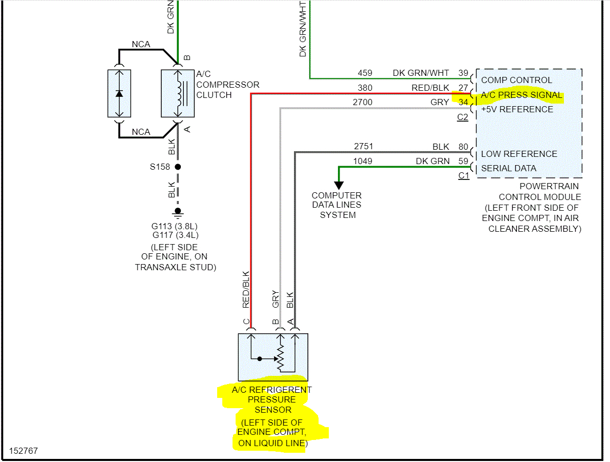

I believe there is only one pressure sensor on this system. It should be located on the liquid line.
If you look at pic 1 below, it shows the wiring schematic for the system. Pic 2 shows the pressure sensor location on the liquid line.
