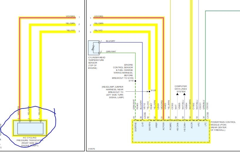

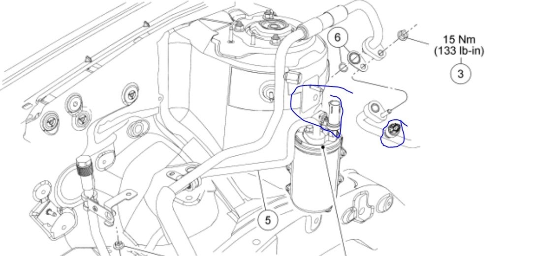

There is a 3 wire pressure sensor I attached for you to view on the dryer. That is the pressure sensor.
https://www.2carpros.com/articles/car-air-conditioner-not-working-or-is-weak
You need to verify a 5 volt reference signal to the sensor with the AC in the on position.

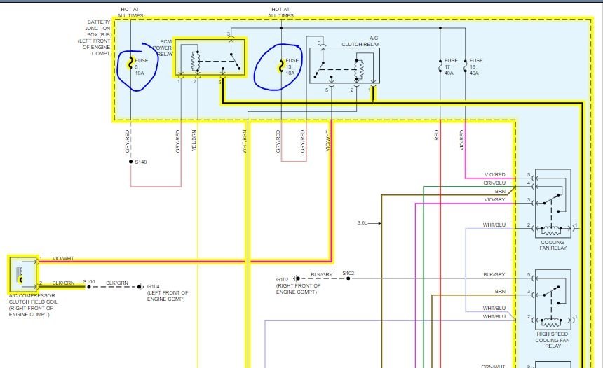

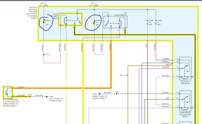

There are also 2 fuses you need to test for power on both sides as well to be sure power is being sent to the relays.
Are you using a machine to install the Freon?
I attached a wiring diagram for you to view of the system.

Thank you. Is that the only pressure switch on the whole system? I thought I saw somewhere that there may be another low pressure switch somewhere by the lines to/from the evaporator, but it's hard to find good information. The dryer is brand new and I think it included a new sensor obviously that's no guarantee that the sensor is working, though.

Yes, it is. Verify 5 volt reference voltage to the sensor.It sends a signal from the sensor to the ECM and that signal is converted into a pressure reading for turning on the compressor.
