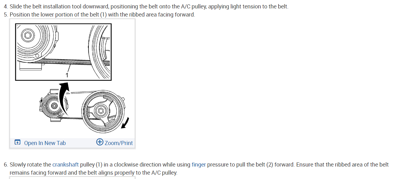

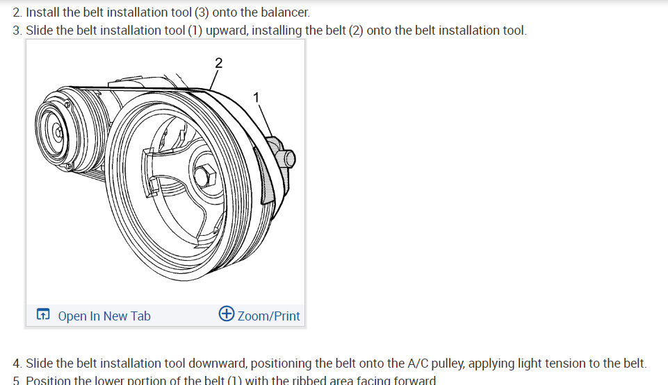

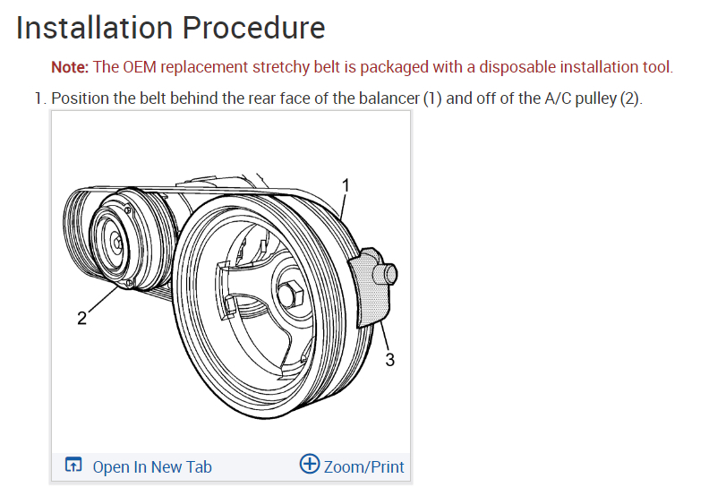

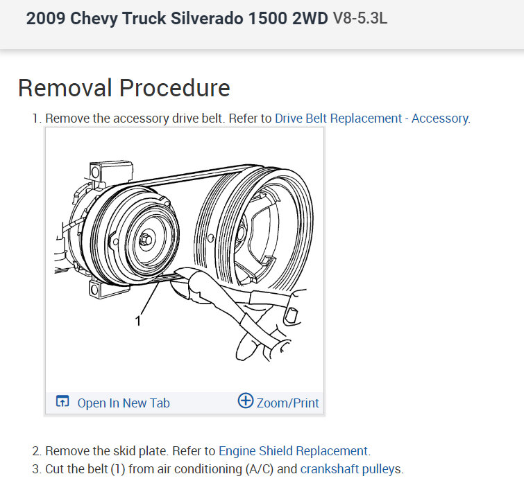

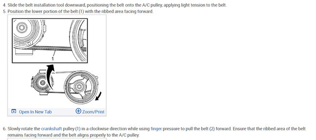

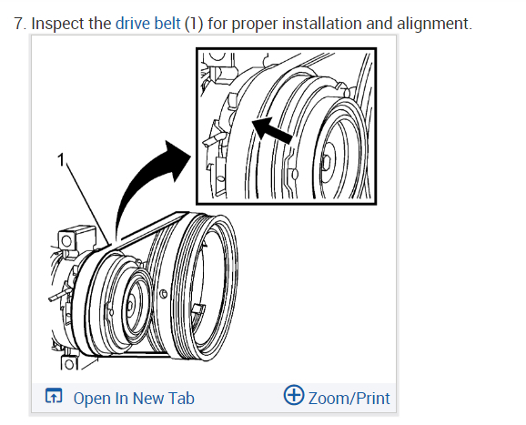

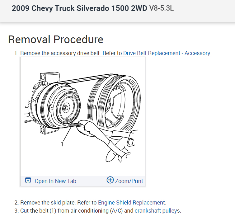

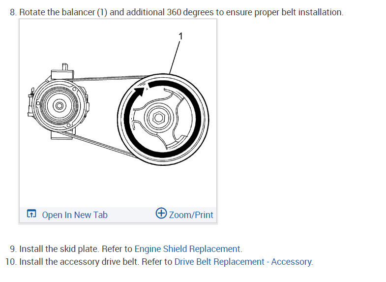

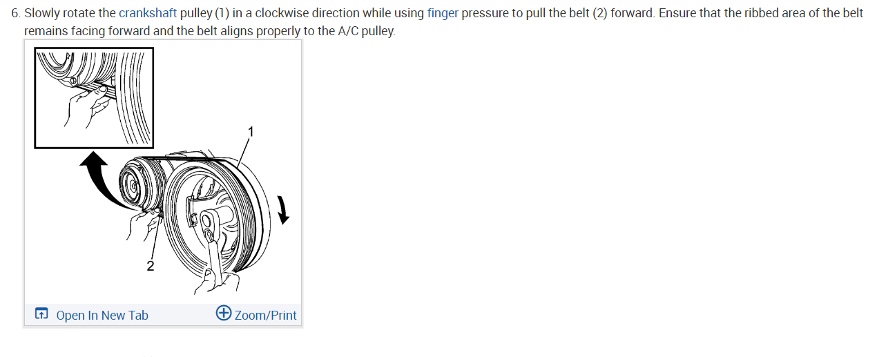

This takes a special belt, it's like a rubber band, you must get the right one or it will squeak. Here are the instructions. Check out the images (below). Please upload pictures or videos in your response of any problems so we can see what to help you with.
Aug 27, 2024 at 9:39 AM
